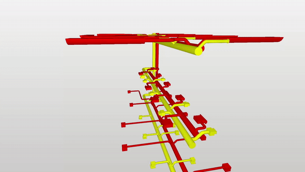

        Hotkey: Ctrl+Alt+R autorotates model
        In 3D view Ctrl+Alt+R autorotates the model. I find it useful for demonstration purposes
        Esc or Ctrl+Alt+R again to stop.
        Spin mode should be chosen for this shortcut to work.
        Spin mode screenshot
        Tip: Could we have adjustable speed?

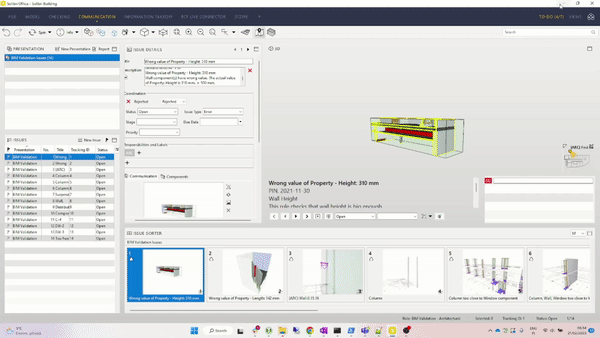

              Automatic presentation
              You can go through all your issue slides in presentation automatically by pressing play button, and also you can control how fast the presentation should play (with a right mouse button).
              Select the slide that you want your presentation to start from. Press play.
              Credit due @vasu

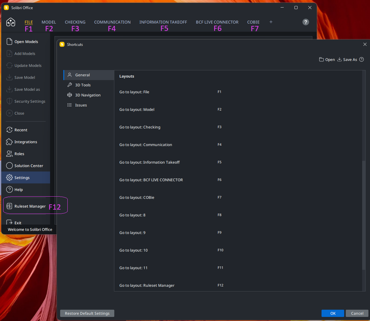

                Layout Switching F1-F12 Hotkeys
                You can go through up to 12 different layouts with hotkeys: F1-F12
                F1 - always File Layout (it’s a non customizable layout)
                F2-F11 - user layouts
                F12 - always Ruleset Manager Layout (click F12 again to go back to the layout you came from)
