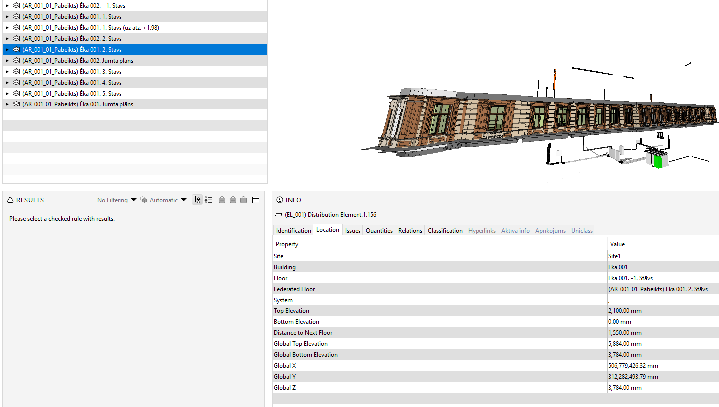

    Hey,
    The flooring hierarchy doesn’t work if you use the integrated one
    (“2nd” floor shows “-1” floor EL elements):
    p.s the IFC hierarchy is the same (site and building)

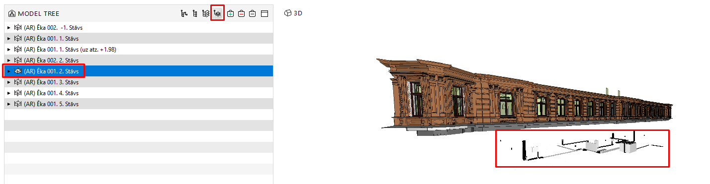

    but if I use the manual selection by floors it works well:

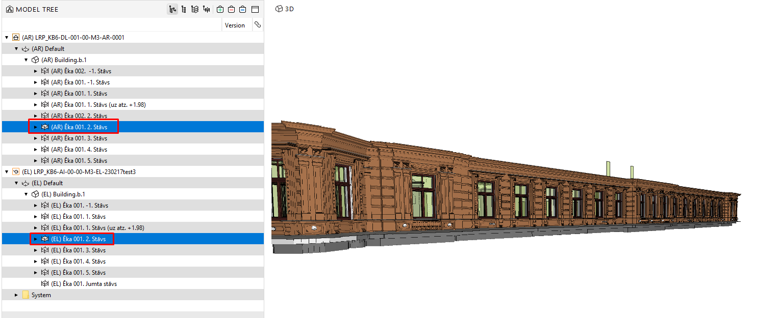

    I know it uses Federated floors (property), but why doesn’t it work if the hierarchy/naming is the same?
    //and for the levels above, it takes EL elements 2x floors down from the AR model.
    *The coordinates are correct, everything is at the right heights as you select them manually.
    Thanks!

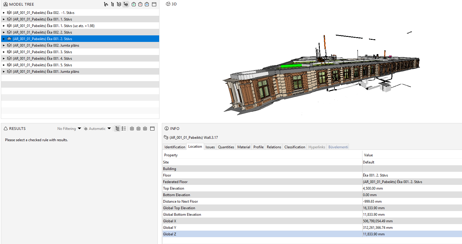

          Hi JSN,
          thanks for the answer 🙂

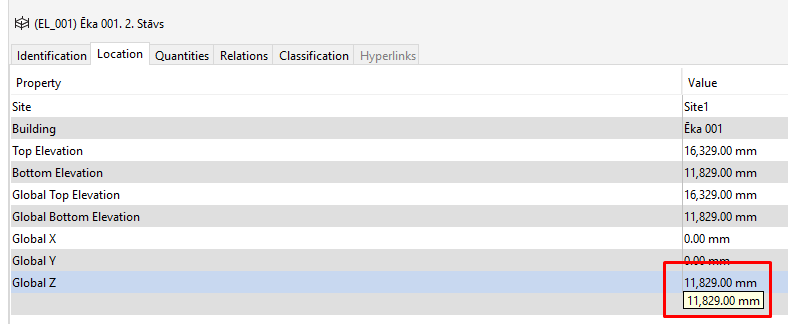

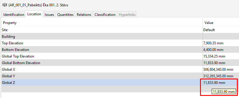

          so here are the 2x element locations:
          EL-
          AR-
          I don’t know how to solve it: the numbers differ its not like they are the same, models align automatically with the correct coordinates.
          Can be that a few mm is an issue? *but then again its 2x story difference… 2nd floor shows -1first floor, which is basement.
          EL-
          AR -
          JSNJ 1 Reply Last reply
            replied to Ingars on last edited by
            @Ingars
            Not sure what’s the tolerance but your top/bottom elevations of the building storeys seem to differ significantly anyhow.
