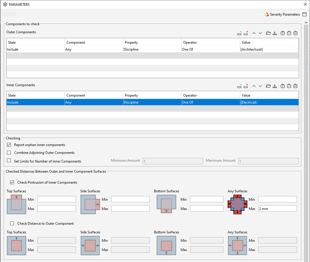

    I am having some issues with checking consistency of to models with small electrical fixtures.
    I am using the rule SOL/234/1.2 and checking for both orphaned components and checking protrusion i any direction with a max value of 2mm.
    However, when checking small components on small components (50x50x10mm) no protrusion is registred and ALL small components in both models are reported as orphaned.

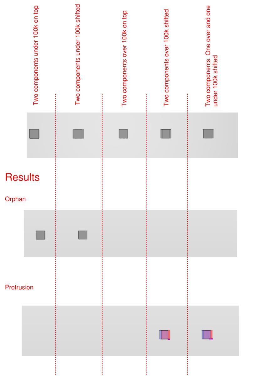

    A small component is able to register protrusion on a larger object.
    After some testing, I found the limit for when this rule is working, and concluded that if a object have a volume over 100.000 mm³ and more than 10 mm of thickness the rule functions properly.
    Is this a known limitation of the rule or am I doing something wrong with my rule parameters?
    Is there a way to work around this, maybe by using another rule?
    Any input is appreciated.
