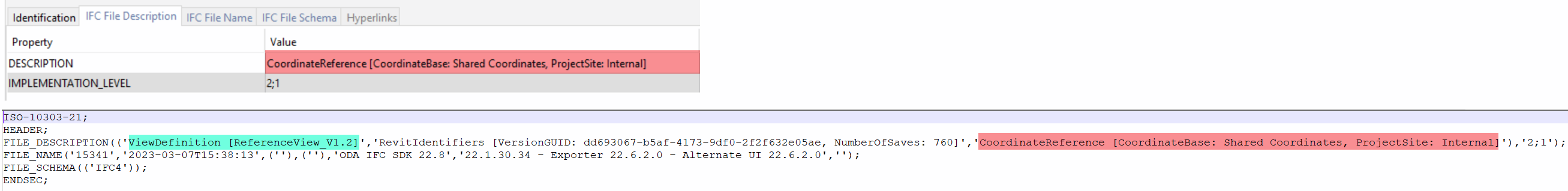

    Would it be possible to fix that Solibri would read the first mandatory attribute of the FILE_DESCRIPTION in the Header of a file, instead of the 3rd (optional) attribute?

      Issue is fixed in 9.13.4.
