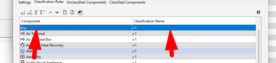

                  We made a classification where we placed the components in a classification with the same name.
                  then we can filter by this classification.

                  • T Offline
                    T Offline
                    twosk
                    wrote on last edited by twosk
                    @Pauwels-Tom thanks, does it work like this?
                    by the way your method gives custom sorting like this?

                      • john.lippJ Offline
                        john.lippJ Offline
                        john.lipp
                        replied to Pauwels Tom on last edited by john.lipp
                        @Pauwels-Tom
                        That’s a clever workaround. For those interested, here is a component.classification that includes all components/containers if you want to categorize results by Component:
                        Component.classification
                        Since they the components automatically localize in the column, you can use this regardless of the language you are running Solibri with

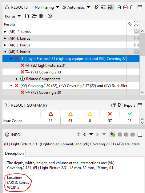

                        • L Offline
                          L Offline
                          lraimo

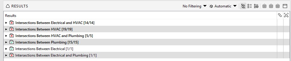

                          Thanks to @SanneVertommen suggestion I got almost the result that I wanted. Only downside is I can not get issue count the same way as in Category hierarchy

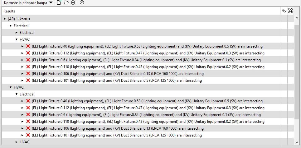

                          Category hierarchy result
                          Custom hierarchy result
                          • L Offline
                            L Offline
                            lraimo
                            #13
                            Unfortunately, with the larger model, I realized that the result is not what I want. For example under Electrical-Electrical there are also issues with Electrical and HVAC
                            Would like to get result by Level and then the same way as in Category hierarchy, bonus would be to get issue counts. Is there any way to achieve this?
