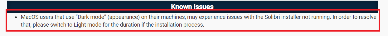

      @sh-yang There is some issue Installing Solibri on Mac. Please check known issues section in 9.13.0 release notes. https://society.solibri.com/topic/2110/solibri-9-13-0-has-been-released/2
      e7092330-bfcb-4a44-9f90-53d0cdccc20f-image.png.
        sh.yang
        Thanks for the hint. The installation was successfully completed with the light mode. However, there is new problem that Solibri does not boot up. How come?
