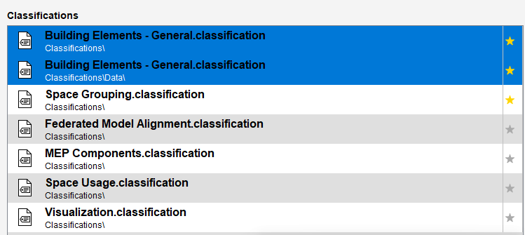

      Could you check if your role has the same classification twice.
      This is easy to reproduce by adding and starring two classifications with the same name.
      The file name can be different, only the classification name matters.
      Cannot have two classifications with the same name open at the same time:
      Role allows to have duplicate classifications:
        @Matti-Kannala said in Ressources already in use?:
        Well, in the role window I have them just once.
