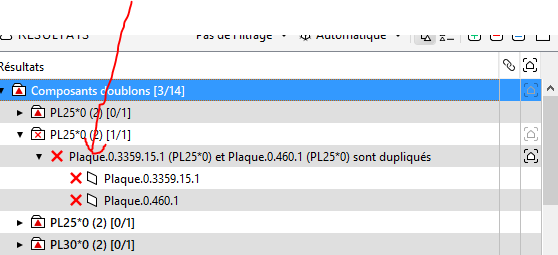

    hello guys
    i did the cheking and i want to know how to put the real names or types of the elements in the presentation because it will be very difficult for the others to know wich element im tralking about with such a tag : plaque.03359.15.1
    please help me out im in intership
    thank you

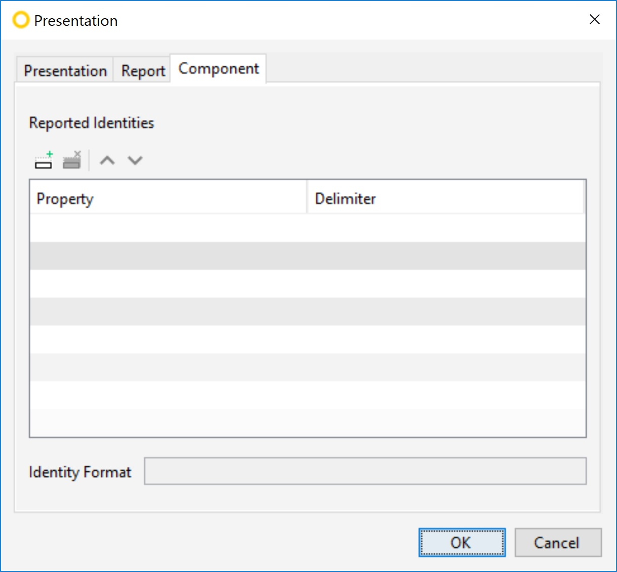

      Hi @oussama-BIM , you can change the reporting identity through presentation settings. To access the settings, go to Solibri’s File>Settings>Presentation.
      On the Component tab, you can select the component identification properties used in the Coordination report. You can select a list of properties to report and a delimiter between those properties.
      Br,
      Anil
      • O Offline
        O Offline
        oussama BIM
        thank you so much sir you saved my life
