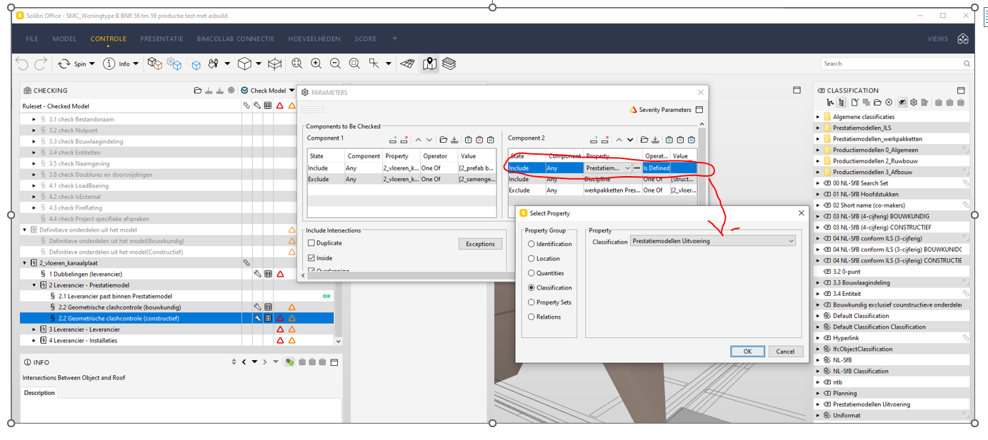

    I use the General Intersecton Rule (SOL/1/5) to clash a production model with the architectural model.
    In the rule I use a classification for the definition of the performance model.
    In the classification I can then exclude parts of which there is a final production model.
    But when I exclude a part in the classification and press check, the adjustment in the classification is not seen and the result remains the same.

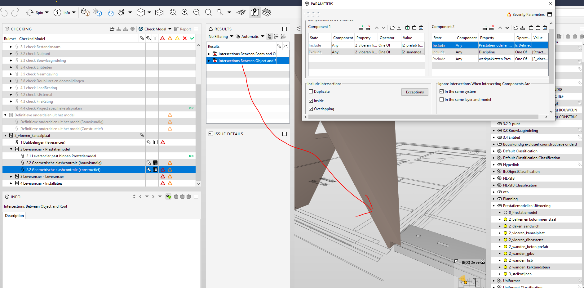

    The classification with the roof
    Clash roof(preformance model) with floor (production model)

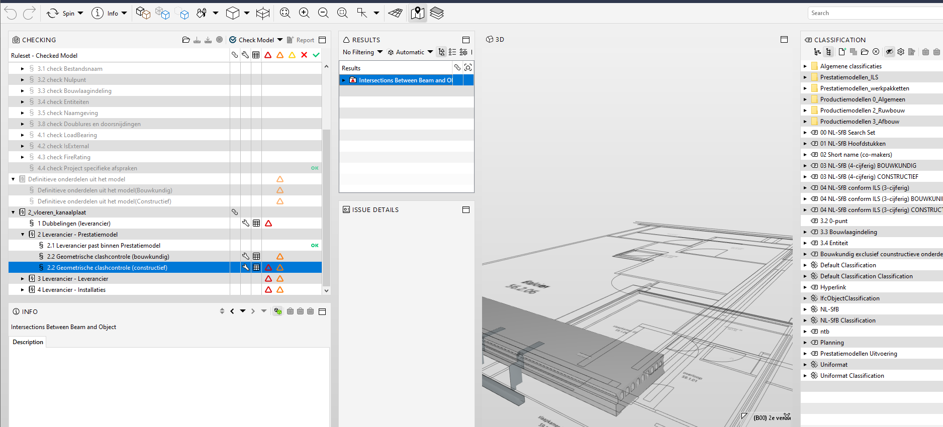

    Exclude the roof in de Preformace model
    Issue remains after check

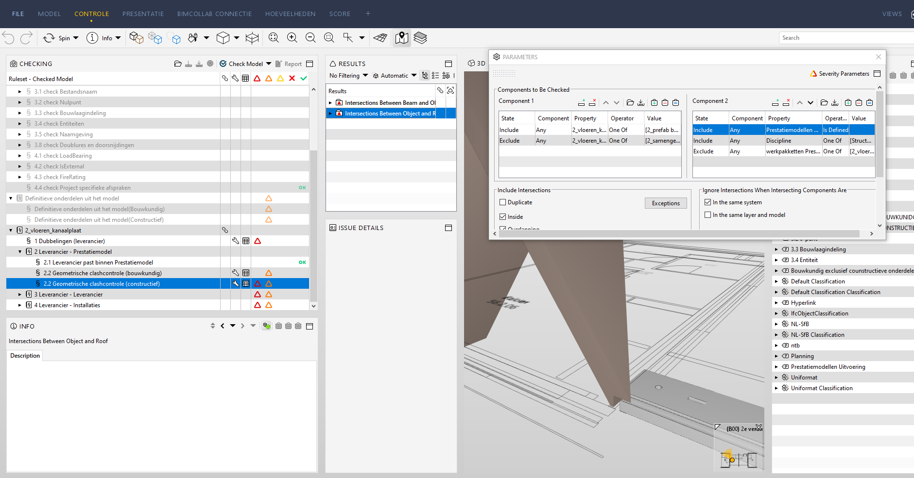

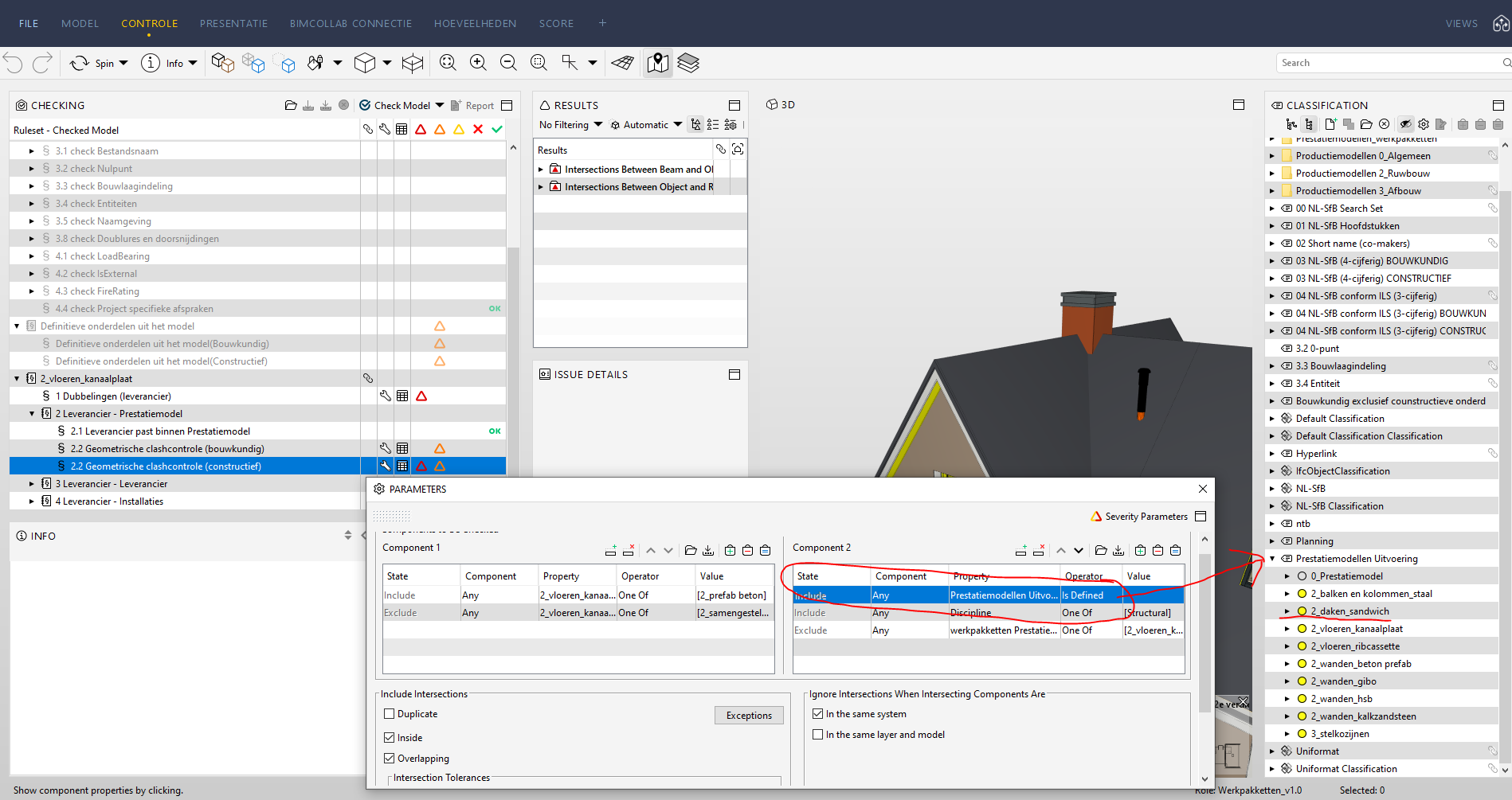

    Pretend to adjust the ruleset
    Result after check, the adhustment in the classification is now visable and the iiseu is now gone in the results

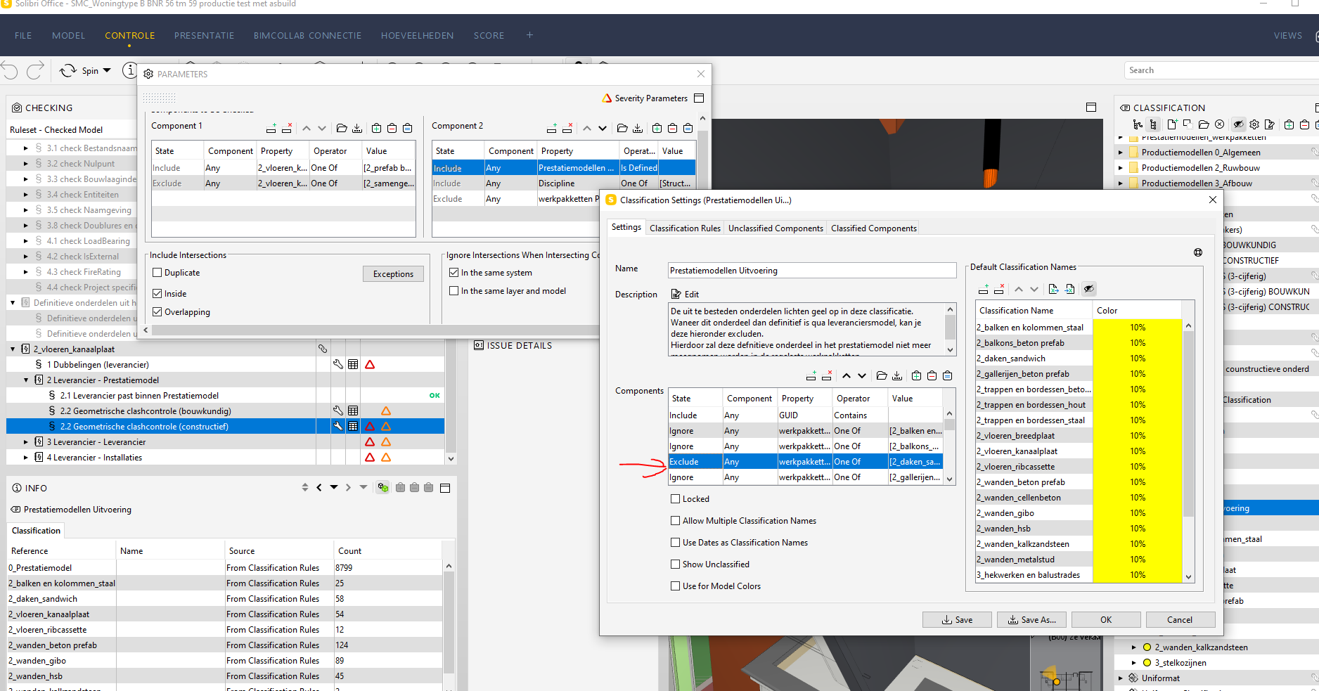

        It seems that changing of general classification components filter (like adding some excluded components - as you did) is not triggering the rule as modified, what in return doesn’t apply changes from the rule to be included in checking and it only runs ‘dry check’.
        I’ll report and log this issue and will look into it. Will post updates here.
        For the quick workaround you can use any of the check boxes to trigger rule changes (as to ‘pretend adjusting’), after classification update
