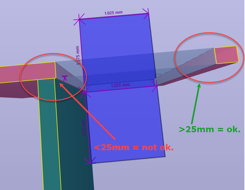

    In my company, we checked the wall nose for the grip of the windows. The wall nose is less or more than 25mm.
    This is the case:
    I need a ruleset to check these noshes, but I can’t get it!
    I have tried to use the rule 216 ‘Wall Validation’. But that is only checked the right (green) side (in the picture), the left side with this rule is ‘ok’, because it did not look to the wall 90 degrees on it.

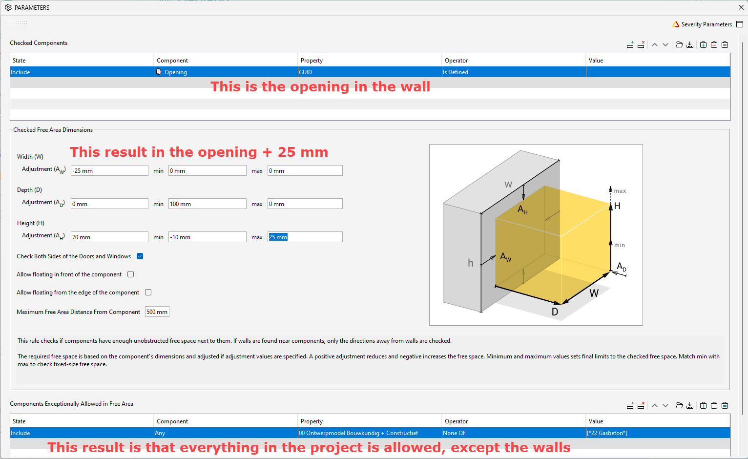

    I have used the rule 226 ‘Free Area in Front of Components’ but the problem is that it clashes with the own wall.
    What I have set in the rule:

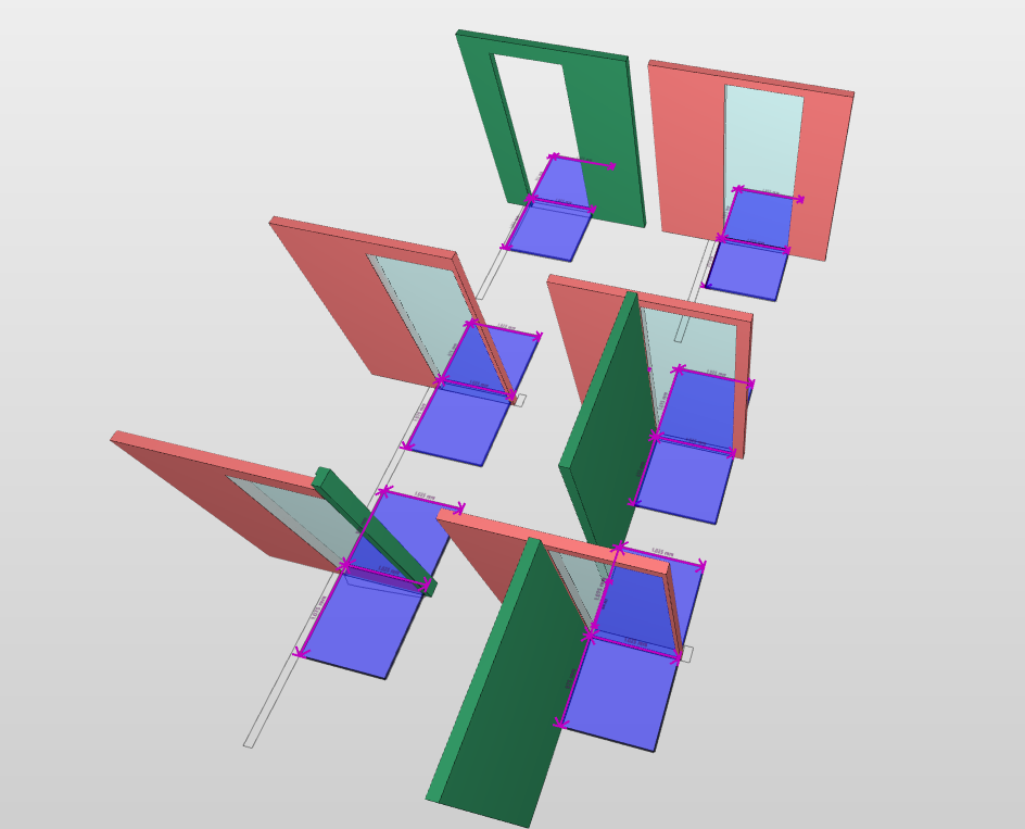

    So far so good, BUT it clashes all my walls:
    Had anyone an idea? maybe with gatekeeper or something else,…?

      Hey there,
      have you tried changing the Operator from excluded components to “contains” instead of “none of”? This should exclude all walls classified as 22 Gasbeton
