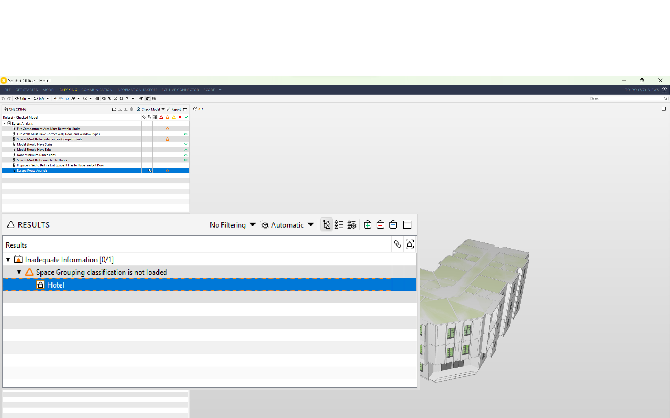

    any one can help me how to solve this problem

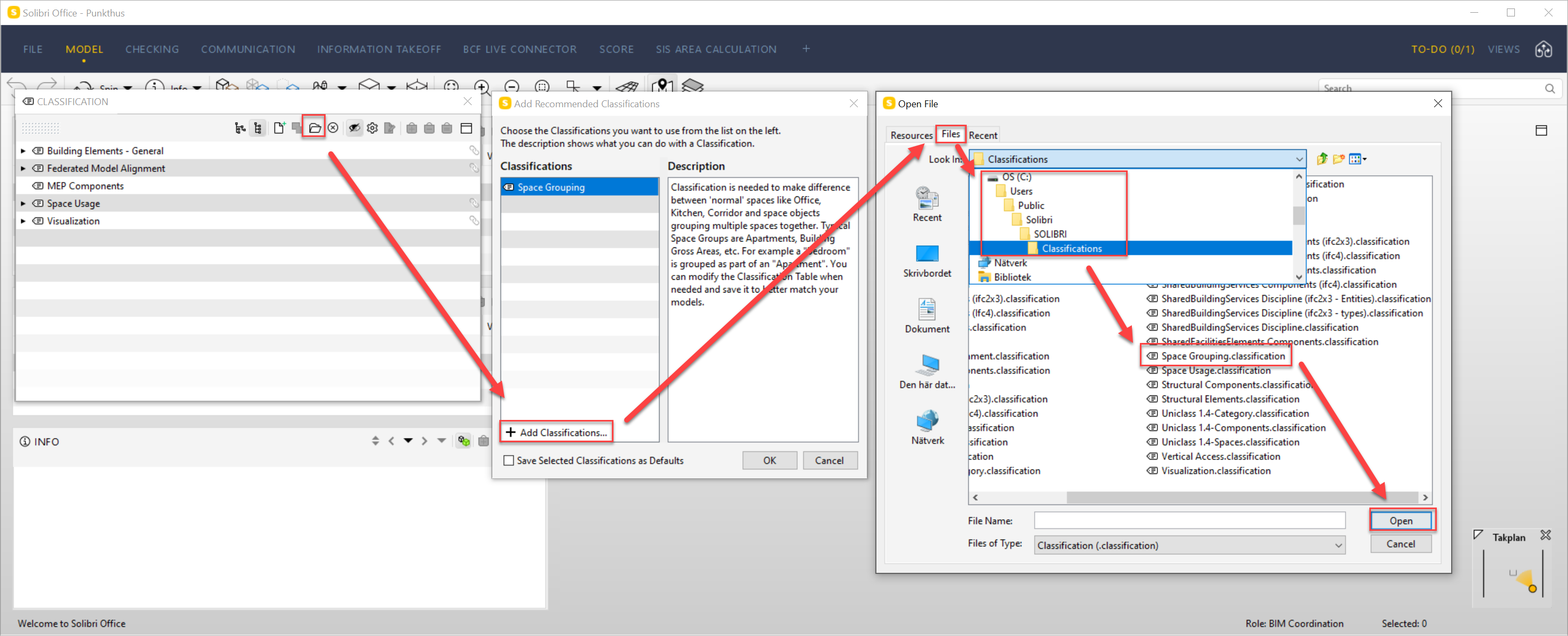

      Lole Flodqvist
      See picture how you can add Classification

        Lole Flodqvist
        Have you tried to load the Space Grouping classification to be able to check the Escape Route Analysis rule?

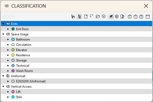

            replied to Lole Flodqvist on last edited by
              Lole Flodqvist

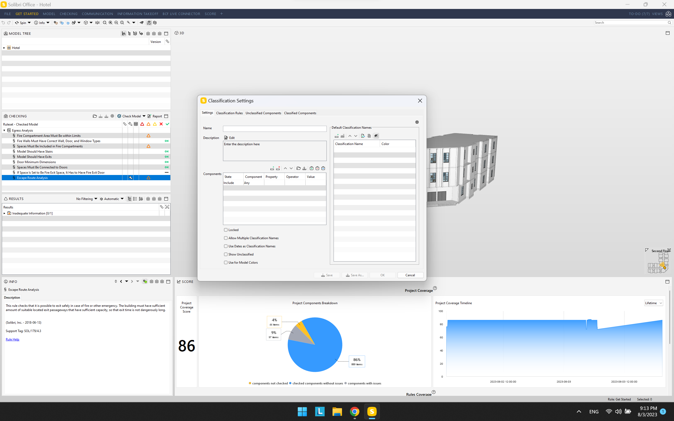

                @Lole-Flodqvist
                after following your steps, below windows appeared and here is not add classification
                  Lole Flodqvist
                  Then you must have chosen wrong in the first step. It seems like you’ve chosen to create new classification. To add a classification you have to click the Folder icon not the Paper with a green plus icon.
