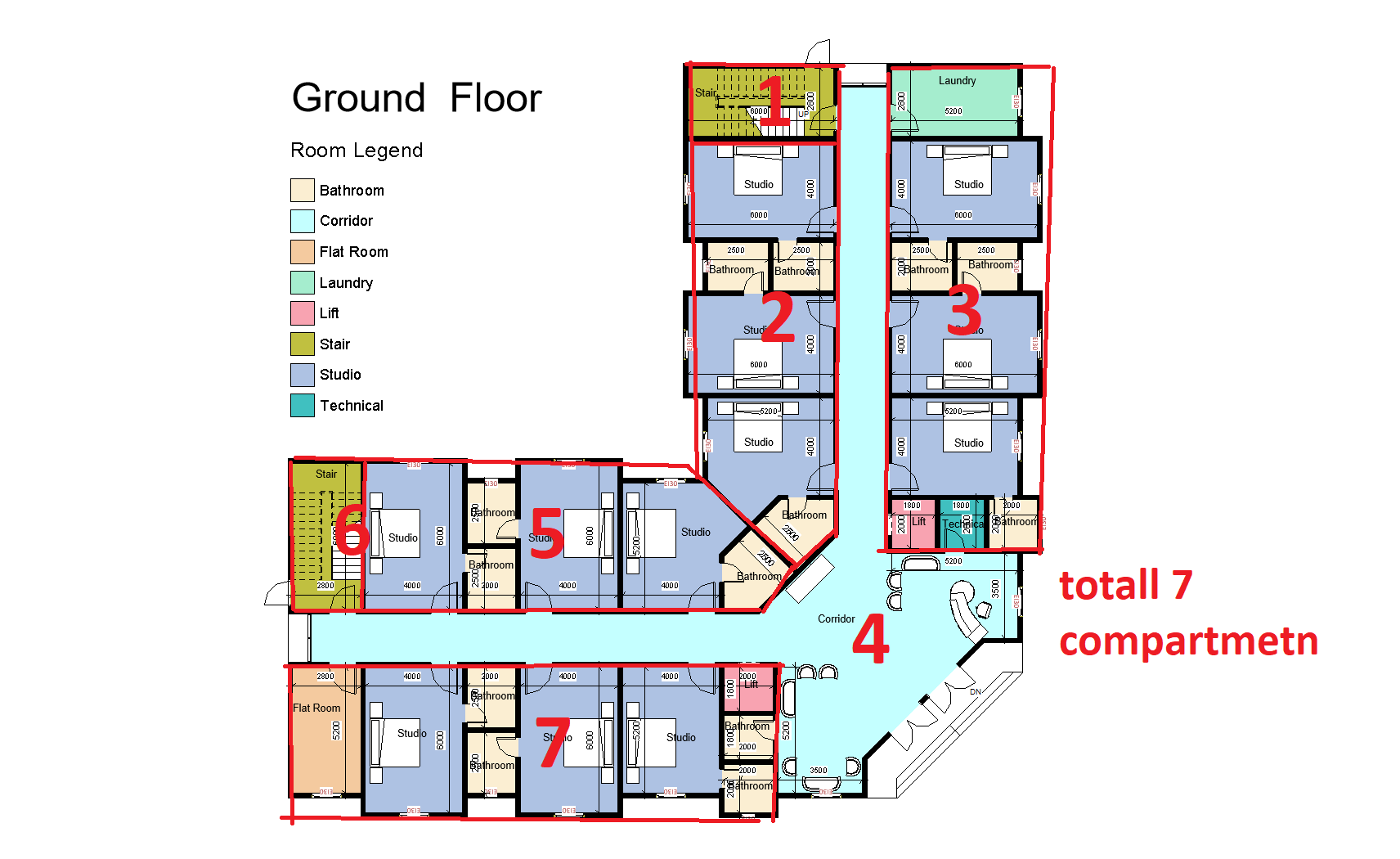

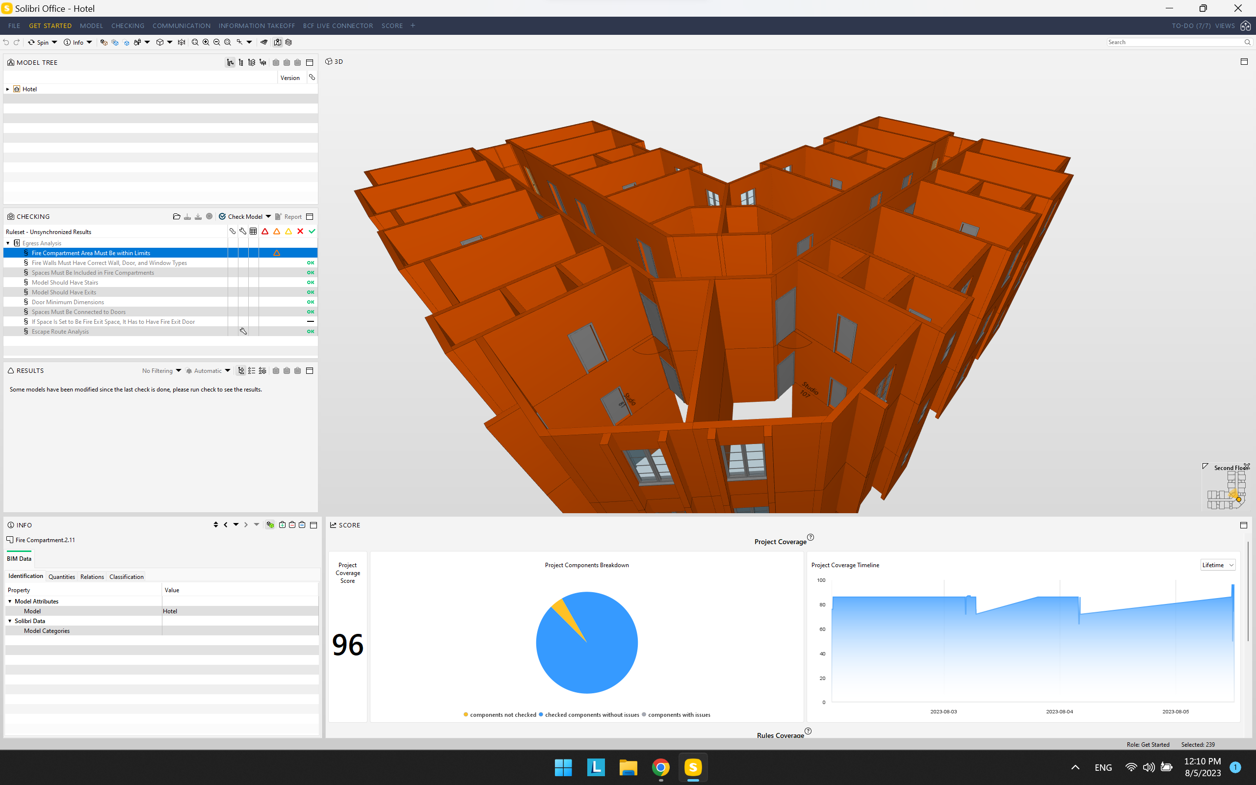

    I need to have compartment like following image but when i create it throgh selection basket after selecting related walls to be fire compartment, the whole building become on compartment.
    if any one help me step by step.
    also if any one has commend on my compartmentation area in terms fo architecture.

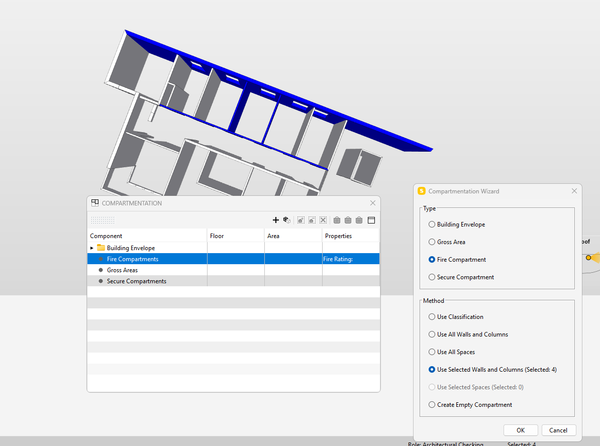

        Here’s a way to do fire compartment with selected walls. I’ve chosen four walls.
        Hope this helps.

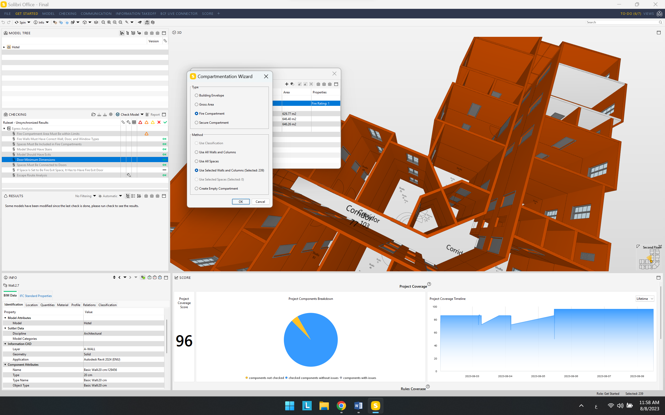

          Hi thank you for your reply
          when i choose selected wall, 239 wall are choosing
            Pasi Paasiala Solibrians
            @Mohammadi Please clean your selection basket first. You can clean it either in Selection Basket view or in 3D’s popup menu (Selection Basket/Empty Selection Basket).
