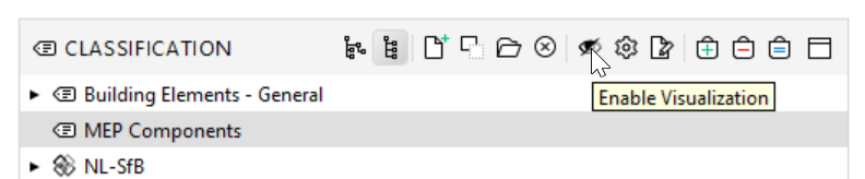

          • B Offline
            B Offline
            b.huijskes
            replied to alex4omnicon on last edited by
            If you select Enable Visualization, do you get different results?
