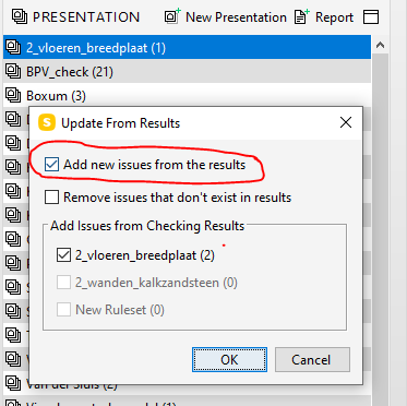

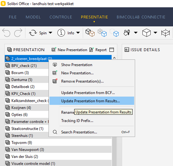

          The snapshot shows a issues created in de ruleset.

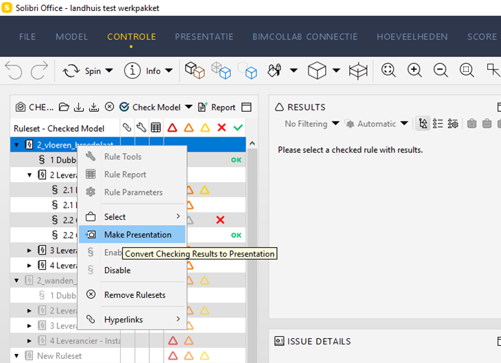

          When you create new issues in the ruleset you have to use the presentation section in Solibri.
          When you import the issues from the ruleset you get them from the presentaion
          Wou can create the presentation form the ruleset by clicking the right mouse button en the create presentation.
          When you create new issues in the ruleset, you can update the presenmtation with the results from the ruleset.

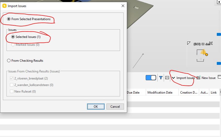

          Select the new issues in the presentation witch you want to sent to BIm Collab.
          Import the seleted issues in BIM Collab

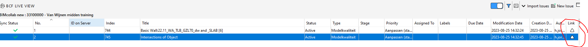

          You see in the BCF Live Vieuw the issues. The triangle shows that this issues coms from the ruleset, imported via presentation.
