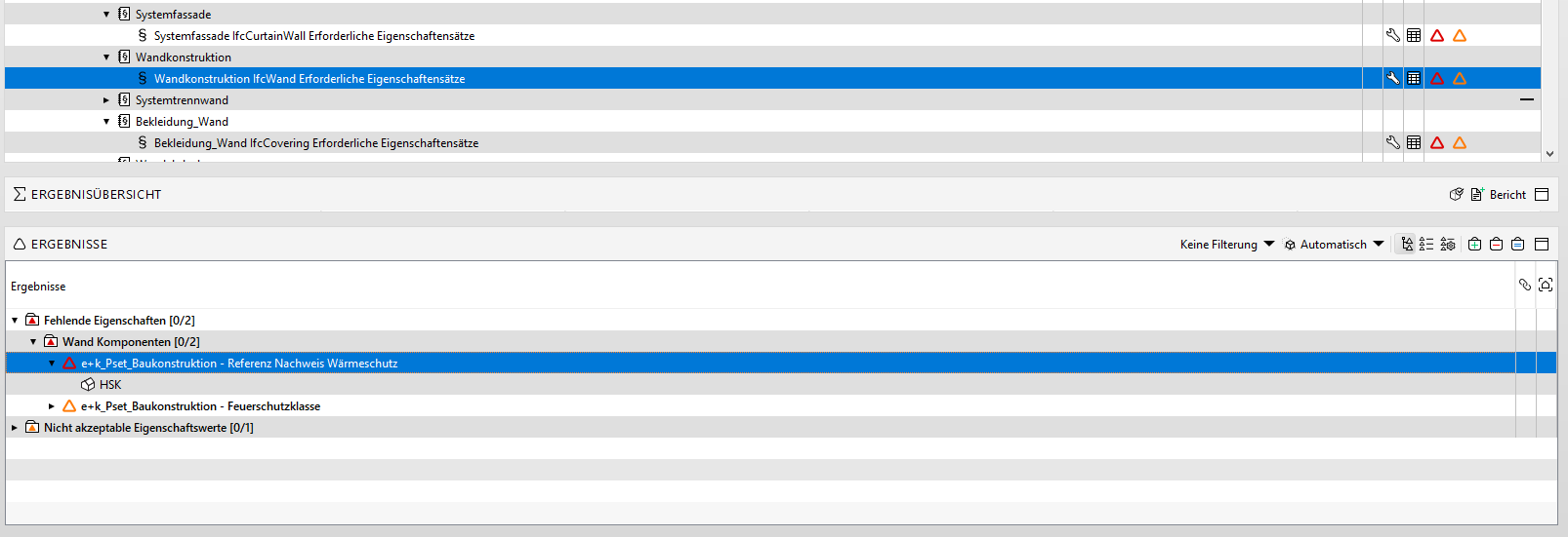

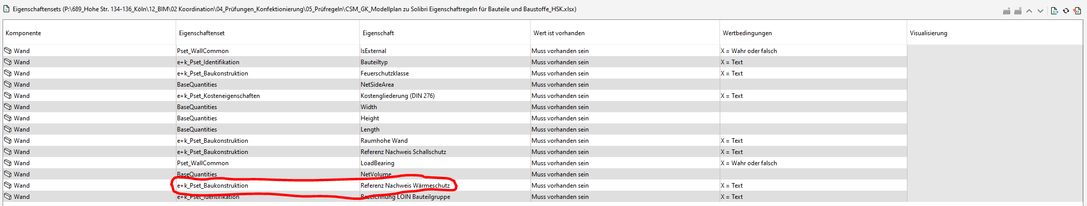

    Here is an example of a rule (SOL/203/2.5) that I am using;
    it is checking that walls have the property “Referenz Nachweis Wärmeschutz” under Propertyset “e+k_Pset_Baukonstruktion”
    All the walls in the project have this property under the correct property set.
    However Solibri creates the following Issue
    How can this be? I have checked the spelling matches, so that is not the reason. The Property is the same name, the PSet is the same name. The rule is checking the correct components “ifcWall”.
    What else could be wrong, other than spelling of the Property and PSet or the wrong components are being filtered?
