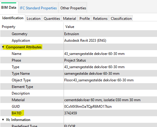

    Is it possible to make a rule which checks wether there are duplicate BATID’s in a model?
    This sometimes happen when for instance floors or ceilings are modelled as one object in Revit but are exported as 2 or more elements to IFC.
    I have tried several rules but couldn’t find one which worked.

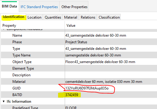

    Underneath an example in Solibri:
    Same BATID with different GUID in the same model:

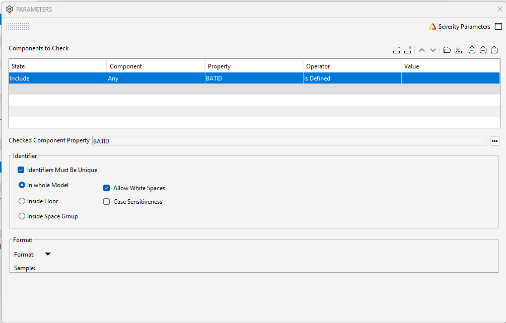

          Have you tried the rule 21 (Components Must Have Unique Identifier) ?
          • B Offline
            B Offline
            BartJeurissen
            Great, thanks very much.
