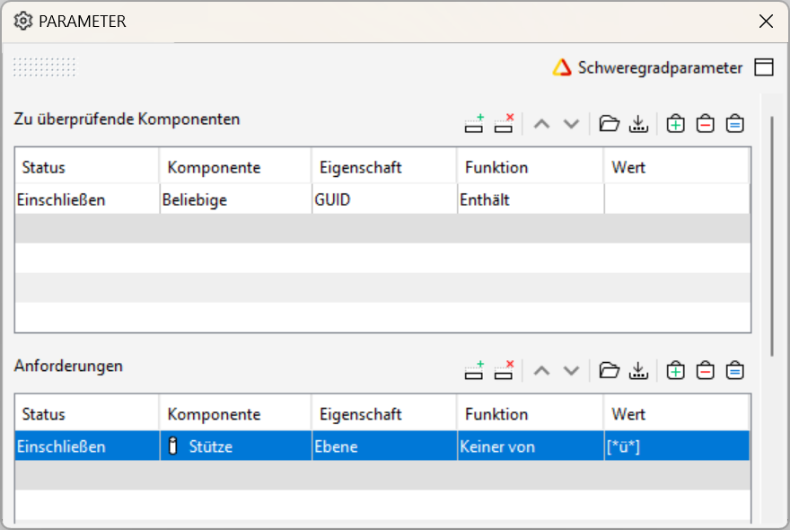

Which rule to check that a property value doesn't contain a certain letter?

230?
There is no “does not contain” so using “None of” should be the way to go.
However, there is a bug or a feature? Afaik the first time the list entries are created you cannot modify the entries unless you close/open Solibri or the ruleset. Then it should work. @Solibrians are you aware of that?
Adding “does not contain” is not a bad idea at all!

Aha …must be a bug. I got it working…thanks

At least I can do the following:
- Press add value
- I need to choose some value from the list to add it to the selected values:
- After that I can go and edit the value as I want (need to double-click on it):
- Press add value
@JSN @Pasi-Paasiala @manuel-furia
Seems that some Properties have this problem and other don’t
Layer, Building, Discipline, Federated Floor (and possible other) are not editable.
Application, Name (and others) are editable.
I will create a ticket for this.
