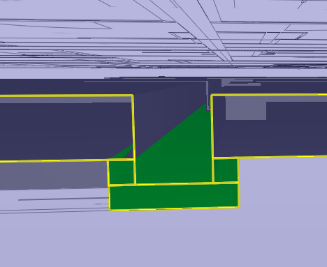

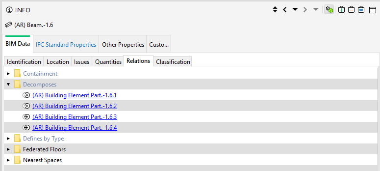

    I have beam that is decomposed of four Building Element Part

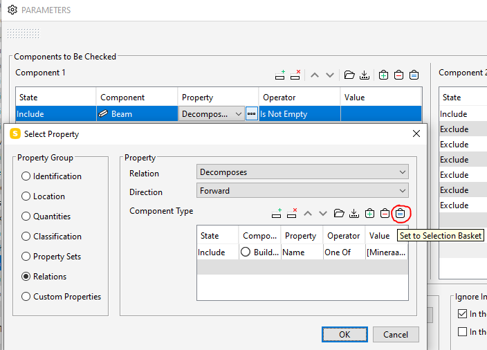

    Would like not take to Components to Be Checked only Building Element Part that name is not “Mineraalvillaplaat värvitud”, but can not get it to work.

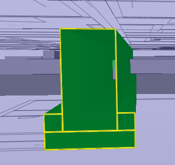

    With Set to Selection Basket button I get Building Element Parts that I do not want
    But with Set to Selection Basket under Components to Be Checked I still get all Building Element Parts of the beam
    How can I make is work?
      In your filter you still have the beams which takes all parts of it if the criteria matches. Also the Mineraalvillaplaat… You only want the parts which are not having that specific name so you need to change beam to building element parts which have a backward relationship to beams first. Then you can exclude those with that name.
