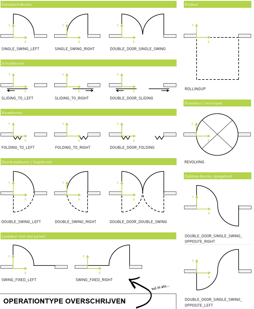

      @Mats_Knutsson This is a known issue when we export from Revit too, and requires that we carefully handle the doors within our projects. OperationType in Revit can be overridden, but using functions like Mirror will upset the overridden values again. Its tricky…
      I am not familiar enough with ArchiCAD to offer a solution, but perhaps you can override the OperationTypEnum to suit your needs. If you want to make use of the OperationType in clearance rulesets, you need to match the actual door swing in the footprint (even if it means the Swing value does not line up with your DIN definition). This means the value is mirrored from how you use it, but (to my knowledge) there is no way to change this.

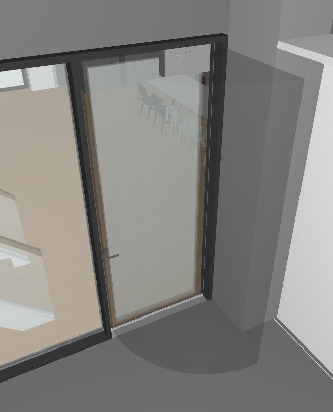

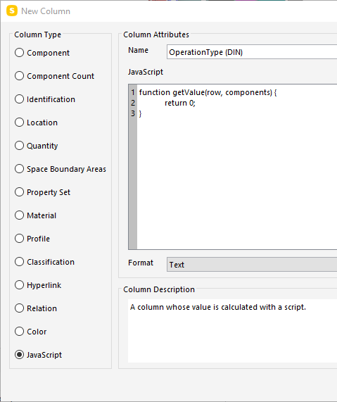

          @Mats_Knutsson It is an opportunity for human errors, yes, but you can try various things to shield people from making mistakes. You can…:
          • Edit the classification name to show the correct name in your DIN-standard, and instruct people to use the Classification over the Info-tab.
          • Physically model the correct door swing and set it to 80% transparancy.
          • Create a standard ITO where you ‘calculate’ the correct OperationType in a custom column
          • Set the OperationType to ‘Notdefined’, to get rid of the ‘garbage’ property values.

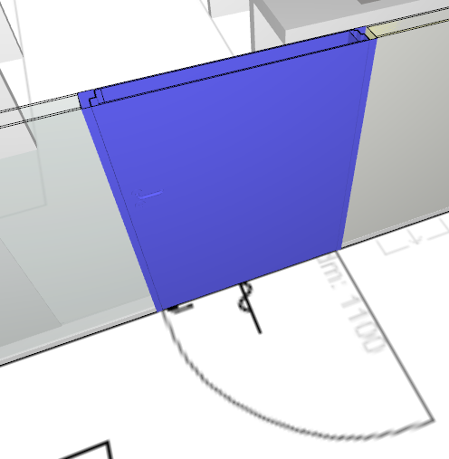

          • Add the floorplans to your SMC so they can manually check the door swing.
          Yes, it is unpleasant, but you can work around it. Hope this helps.

                @b-huijskes I am intrigued by the JavaScript option in your screenshot. I’ve never seen this option before, at least not in the Solibri build I am currently using (9.10.1.137). Where can I find this feature?
                B 1 Reply Last reply
                • B Offline
                  B Offline
                  b.huijskes
                  replied to Remco on last edited by
                  @Remco To my current knowledge, this is a Beta function only (hopefully available soon as a standard function). @cpreidel has provided some information in another topic (here). Hope this helps.
