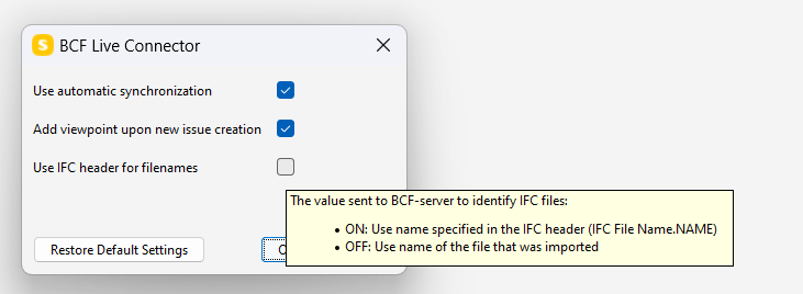

                    #15
                    This is now done in Solibri 9.13.8.
                    https://society.solibri.com/topic/2826/solibri-9-13-8-has-been-released
