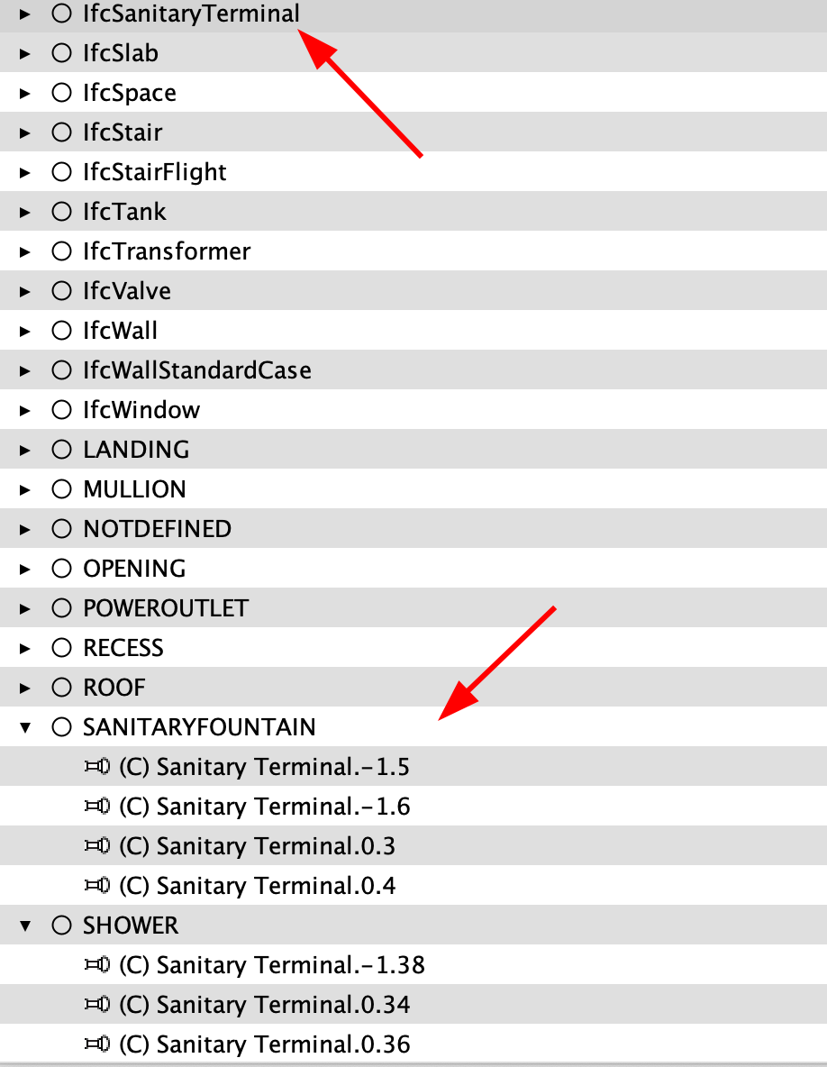

          Would a multiple classification / All matching that uses the =1 / =2 nomination to classify the component directly to their Ifc Entity and Predefined Type work?
          Ifc Entity - Predefined Type - Multiple Classification.classification
