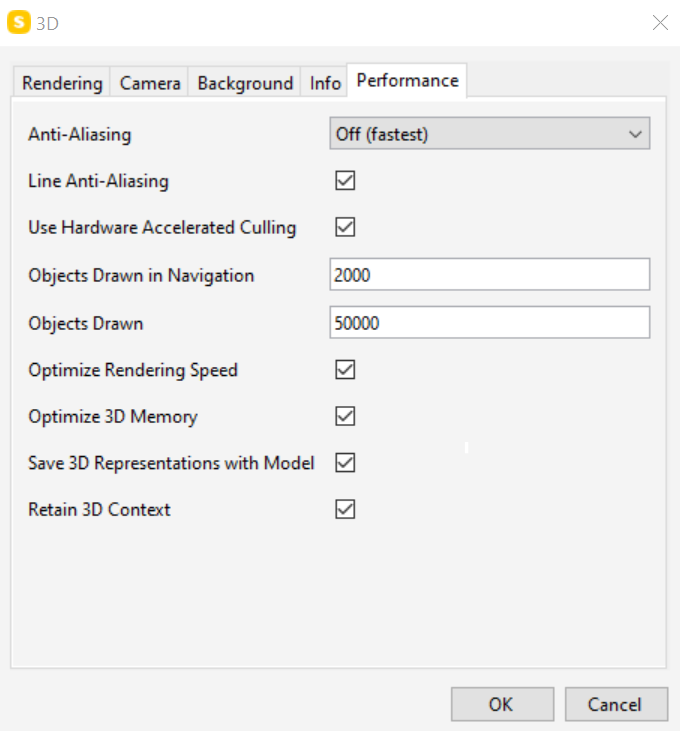

                    @Matti-Kannala I am quiet new to Solibri and I am still learning but I do wonder, where do I find this setting? 🙂
                    • V Offline
                      V Offline
                      vasu
                      You find the settings @Matti-Kannala mentioned in Performance tab under File -> Settings -> 3D…

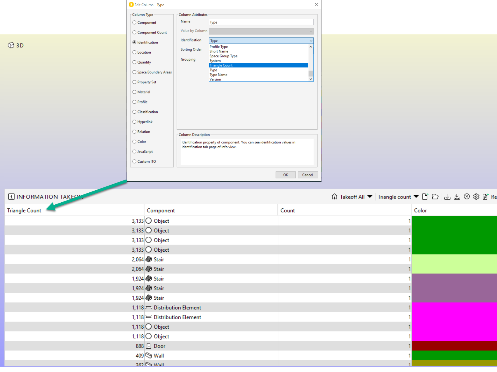

                          You can also check the model if it has a lot of lines in it(triangle count)
                          @Harmen-Jorritsma How do I get an overview from the trianglecount per IFC?
                          • Lauri LuomaL Offline
                            Lauri Luoma Solibrians
                            #13
                            @lvsteijn
                            In Solibri you can see the triangle count by listing the information in ITO:
