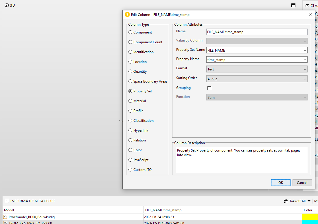

    Hi
    Is there any way to get IFC Header Properties to Information Takeoff?
    At the moment I can add column, but no data is shown there

      @lraimo ,
      Use the time stamp in the project, to lcick on the model and look by the info under IF Header Properties --> IFC File Name.
      Create a ne Information Take off, select in setting only project!
      Add model and the file name as a colum, and done.

        yes thats possible, the Time stamp is connected to a model, not a component.
        if you select “Identification/model” in youre first row it schould work

            @lraimo ,

              Timestamp ITO met model.ito
              this should work
                lraimo
                Both answers worked. Thanks
