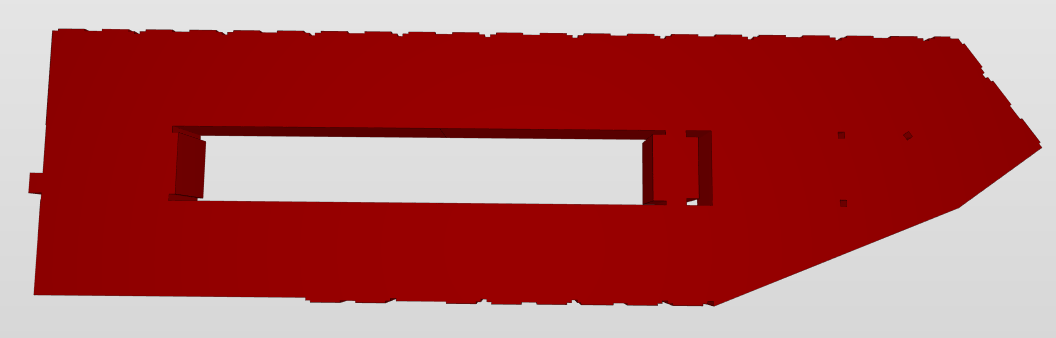

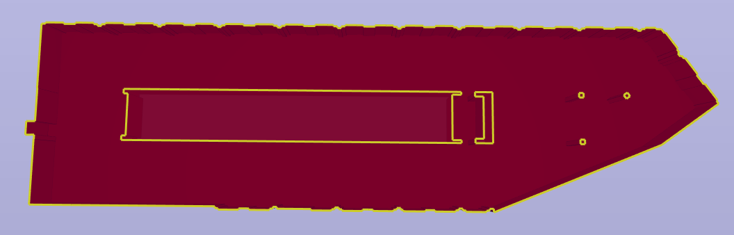

        I have a similar issue where I do want to see the room, but there is not an easy distinction between
        • an enclosed volume (the room)
        • a surrounded empty space surrounded by the room)
        Here is how the IfcSpace looks like:
        And how it looks when I cut through:
        You see a slightly different opacity, but once the rest of the building is in the background this becomes impossible.
        Any way to solve that?

              replied to Alex.J on last edited by
              @Alex-J said in Sectioning Settings exclude Rooms:
              The holes are filled in sections ATM. We have not yet implemented this.

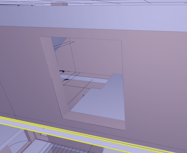

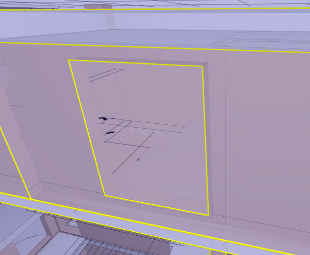

                      #15
                      Hi @Pasi-Paasiala,
                      just to let you know this issue is still cumbersome.
                      Here’s another example with a wall opening:
                      cutting in front of it:
                      cutting through it:
                      You can see the visibility is quite bad when the plane goes through it.
