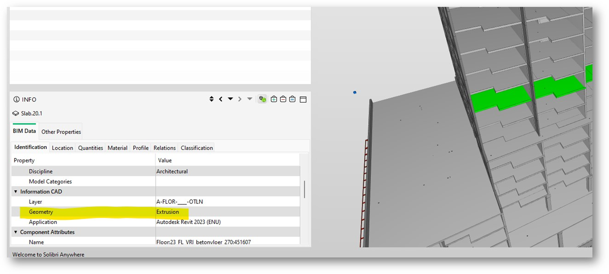

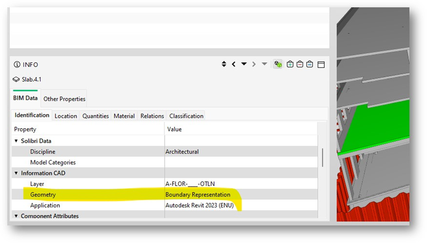

    Can anyone tell me the difference between Extrusion and Boundary representation. Sometimes a slab has the geometry Extrusion and sometimes Boundary representation while the floors in Revit have the same properties.
    Is it possible to export the floor to either property?
    Thank you in advance
    Erik
      The geometric representation is defined by your exporting application. The difference is explained e.g. here:
      https://damassets.autodesk.net/content/dam/autodesk/draftr/2528/180213_IFC_Handbuch.pdf
      One issue you may notice within Solibri can be related to material representations …
      https://society.solibri.com/topic/2327/material-information-thickness-not-shown-correctly/5
