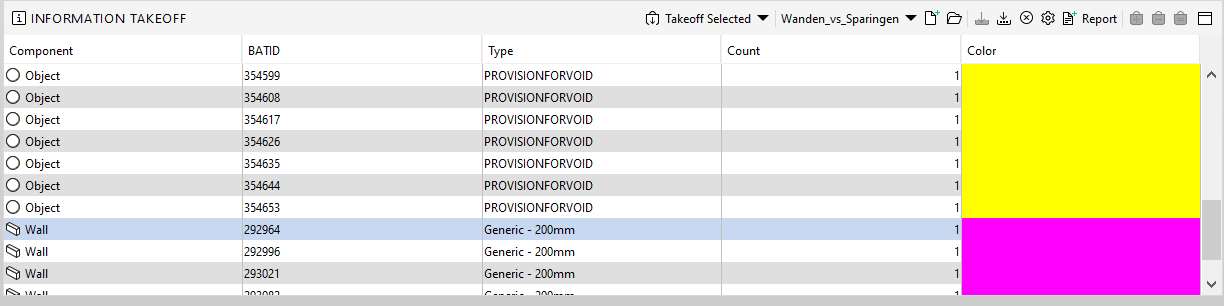

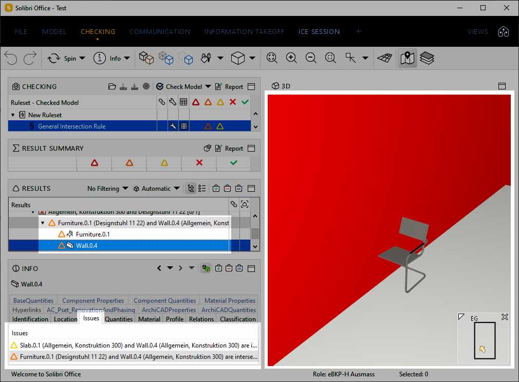

          @pasi-paasiala said in export clash result:
          Issues are not available in ITO at the moment.
          As noting has changed here in the meantime I would also like to hear if there is maybe a way to achive this - reporting all the connected issues of a components and their ids. Probably using the API but I am open to any helpful suggestion!

            #14
            @JSN At the moment Solibri API doesn’t give access from components to issues.
            Have you tried creating BCF with Autorun?
                Of course, it depends what you want to do.
                Yes directly from Component to Result is not possible. But it is possible to iterate all the results, build a mapping from Component back to the Result using Result.getInvolvedComponents and Result.getRelatedComponents().

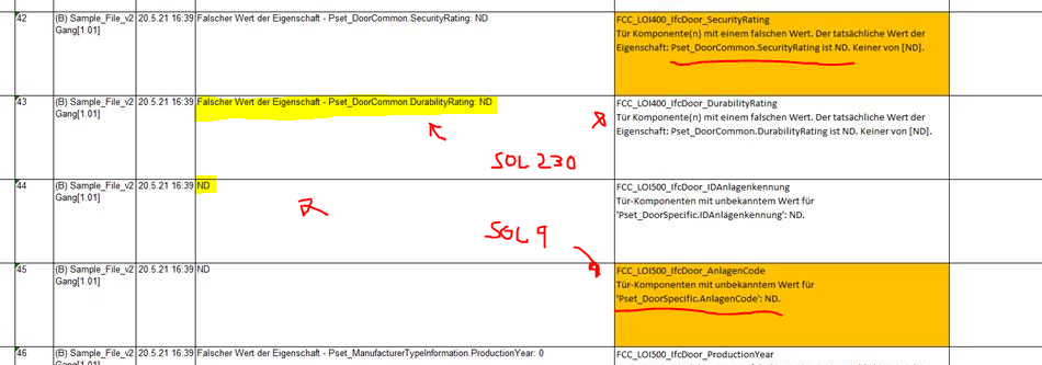

                  Hi, yes I was considering Autorun for exporting the CoordinationReport as xls as this is the closest I could get atm. However it would be more convenient if this kind of “ITO” would be achievable on a different approach as well.
                  Some thoughts to Autorun and the Reports here …
                  • First of all I think it is not possible to also export the Result Summary xls, that would be a nice feature too.
                  • Second I wanted to ask if there is a possibility to define that the latest (just via autorun created) presentation is exported as I think this is not the case atm - does it always take the first or did I do sth wrong?
                  • Regarding Report Templates I also wanted to know if there is any chance that fields with formulas can be used anytime in the future as currently they are not usable.
                  • Then there is this discrepancy how the Titles of the slides depending on different rules are created - SOL 230 or 203 are fine but SOL 9 is just giving the wrong Value back - and also in the Description it is a bit different which makes it harder to filter it out later on - I am refering to the attached image … is this on purpose?
                  I mean it has also always been showing up like this in the results but in this context it is definitely a problem. Moreover the information about the rule is not exported so I cannot just say if SOL9 take this part of the description and else use that … I am not saying it is impossible, but it makes things harder.

                    #18
                    @lasse-lindqvist said in export clash result:
                    As also mentioned in another post due to the limited amount of information which can be stored in an excel cell (which limits the total number of attached components) it seems like that the above suggested autorun method is not really eligible for achieving the desired result.
                    As long as there is no better option to export checking results, and/or ITO is not able to access component related issues aka checking results, I guess the API is the only solution at the moment …
