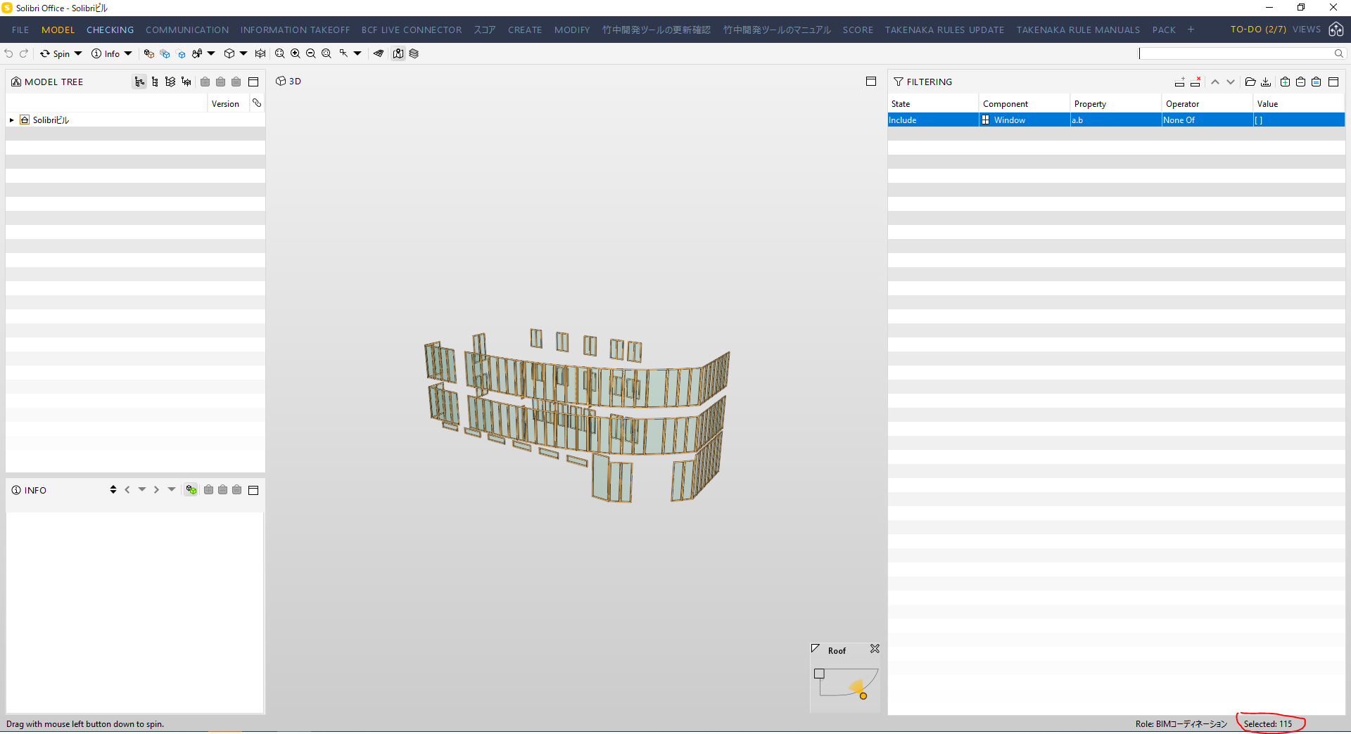

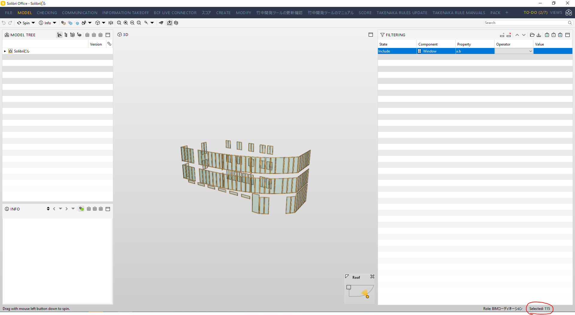

    I hava a filter like this
    Property setting:
    Window components don’t have that property.
    When I put blank to Value, filter doesn’t return any components
    But i put a space to Value, filter returns components.
    Can you explain for me? i think if components don’t have property, filter always doesn’t return any components
    Thanks

        @Matti-Kannala we have no problem with other operators, we just want to confirm is this expected behavior?
        I anticipate that with a non-existent property, irrespective of the value or operator used, it should yield consistent results. Why the one with a single space in value return components when other do not?
        Include + Wall + a.b + None Of + Null
        should be equal to
        Include + Wall + a.b + None Of + Space
        because property a.b does not exist in the entire model.
