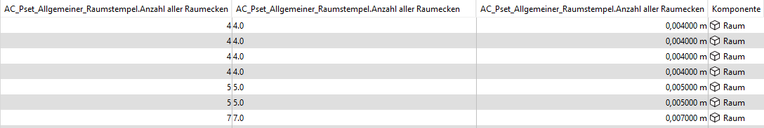

          The unit settings matter as in the example below you see that the same property (or quantity) is displayed differently depending on which datatype I chooses for the property as the default SI Unit within my IFC file is set to mm whilst the Solibri lenght measure unit is specifically set to m …

              Here also an Example of an IfcReal
              which shows “your values” when you willfully change the datatype in the column settings.
              The same IfcReal as Double | Text | Lenght from left to the right …
