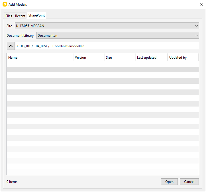

        When you want to add a new model to the coordination file and you click on ‘SharePoint’, the system will automatically connect to a specific project (Site), Document Library and open a specific folder. (see screenshot) It doesn’t matter in which project you are working, it will always send you to this specific folder. This folder is the first folder I have ever connected to the SharePoint environment. It might be a bug in the script behind?
        Even if you change the path to the correct site, document library and folder of the specific project you are working on, everything is reset to the settings from the screenshot from the moment you click ‘Open’. That means all new updates will not be listed by Solibri because the file path is reset.
