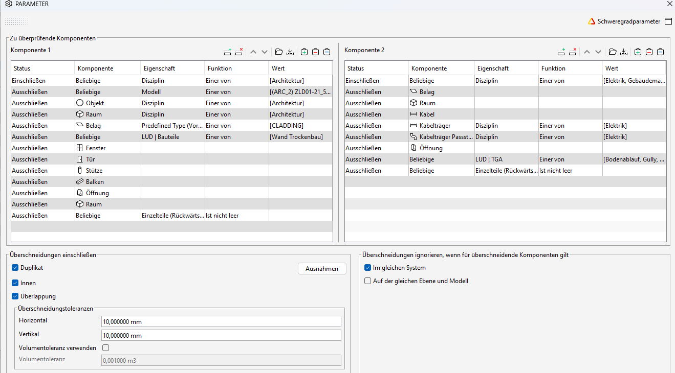

    The responsible rule looks as follows:

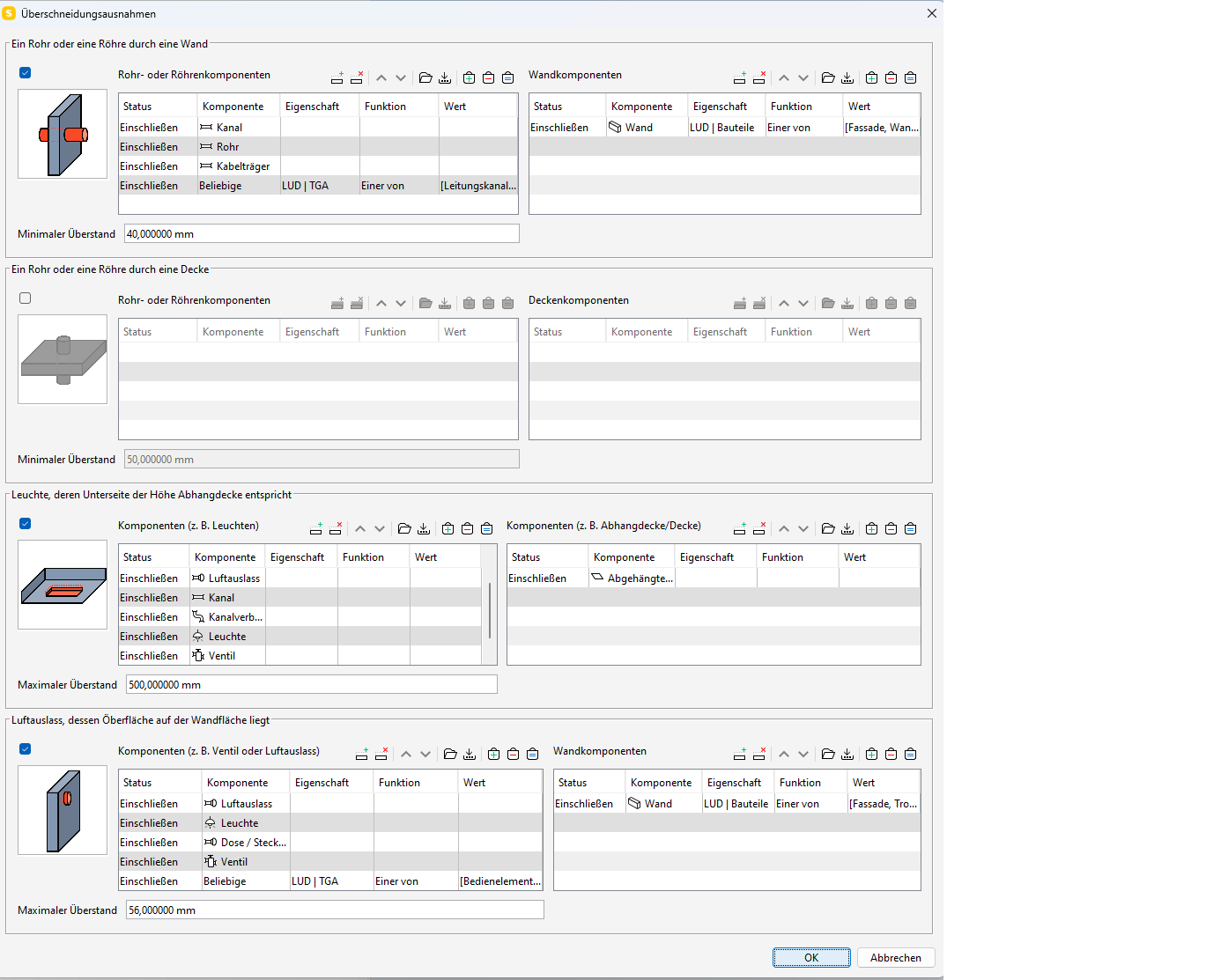

    to reduce the amount of issues there have been made some exceptions:
    When those Exceptions are deactivated the rule processes correctly, but considers too many elements as clashes. As comparison you can find two screenshots:

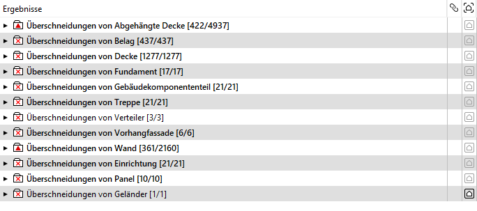

    With Exceptions and an amount of issues as intended

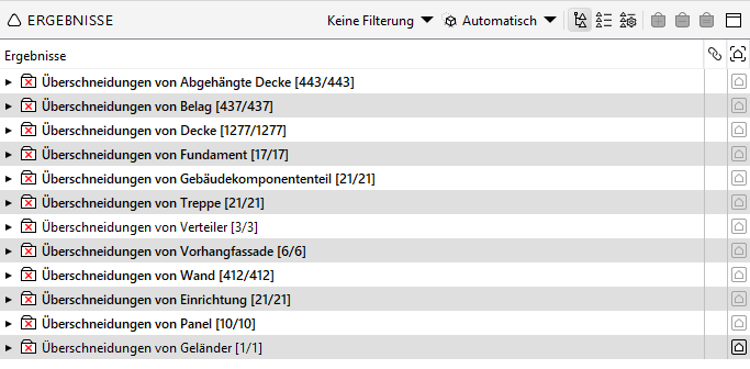

    Without Exceptions and many unnecessary issues, but at least no Error-Symbol
    Interestingly the rule works fine after deactivating the exceptions, running the test, reactivating the exceptions and running the test again. Only pity is that 21 checked issues from “Überschneidungen von Abgehängte Decke” are considered as new issues, even though they are exactly the same and have been checked and marked previously.
