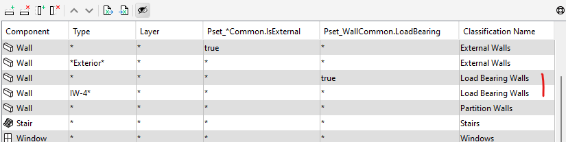

        The search for multiple values in this manner works within the filter options of the ITOs and the classifications. I would like to use it for the classification rules, for instance, with several possible values for type.

          @brinkman Can’t you just add multiple lines?

            We work from a large externally managed list. We want to keep the link with the original list as intact as possible.

              Keep the list as it is and use e.g. Power Query to transform into a new file as needed that can be linked?
