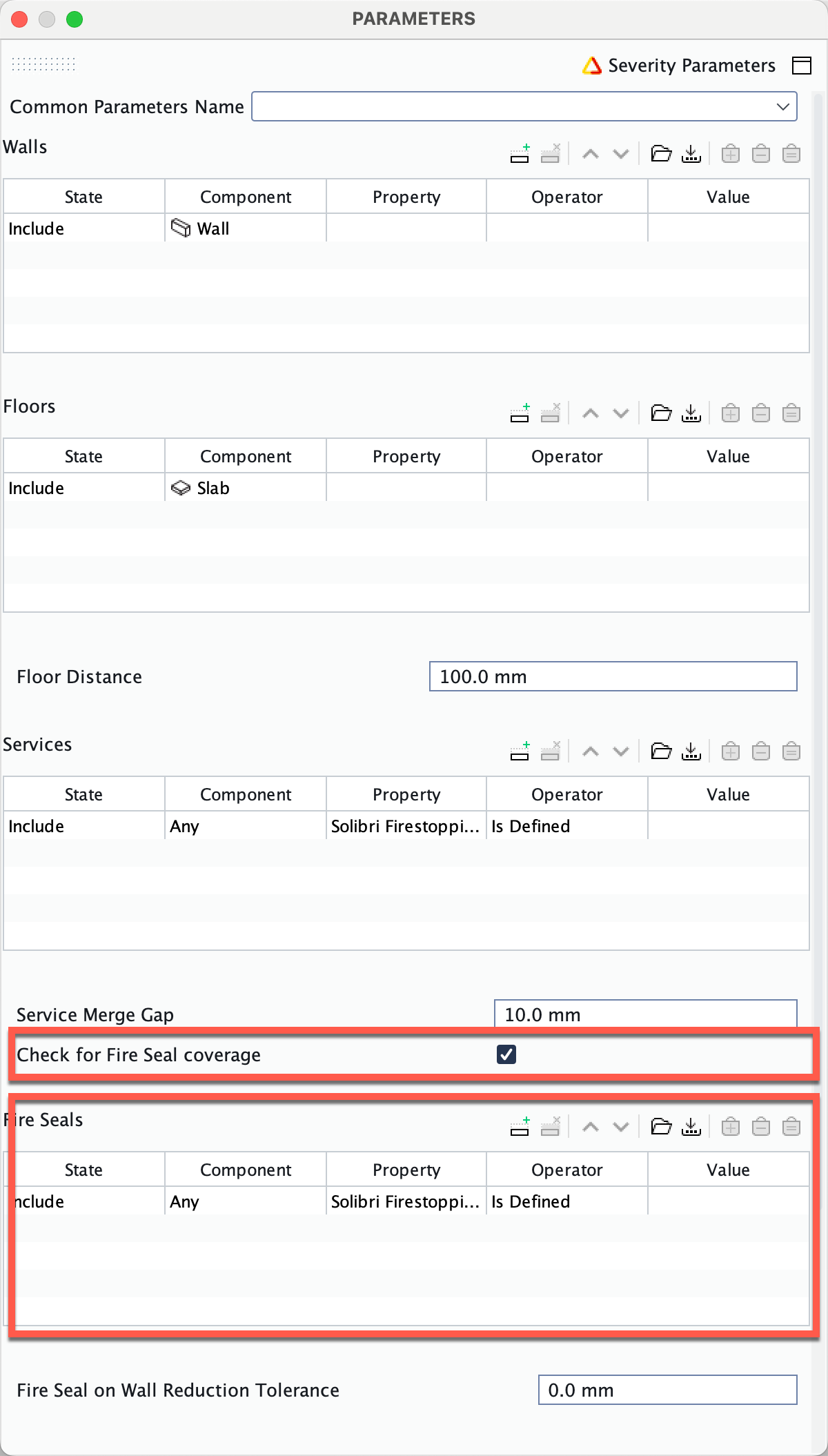

      Hi, you’re in luck. This is exactly what the Identification rule does in the Fire Stopping rules. You can check for where you have service penetrations in walls and floors and then with the option of checking to see if the penetration is covered by either a Fire Seal, BWIC or opening component.

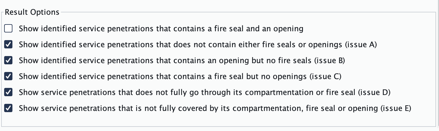

      We are also updating these to check for different scenarios i.e. where a penetration occurs and there is one of the following cases
      1. Service penetration with opening and fire Seal - Passed Condition
      2. Service penetration with opening but no fire seal
      3. Service penetration with no opening but fire seal present
      4. Service penetration with no opening or fire seal.

          Hi Mathieu, The Identification rule has a check box for identifying where this occurs
          Check the option and the supply the component that it needs to cross i.e. a BWIC or Fire Seal using the filter / filter with classifications.
          We have a update coming soon to this rule which will allow you to check for different scenarios.
