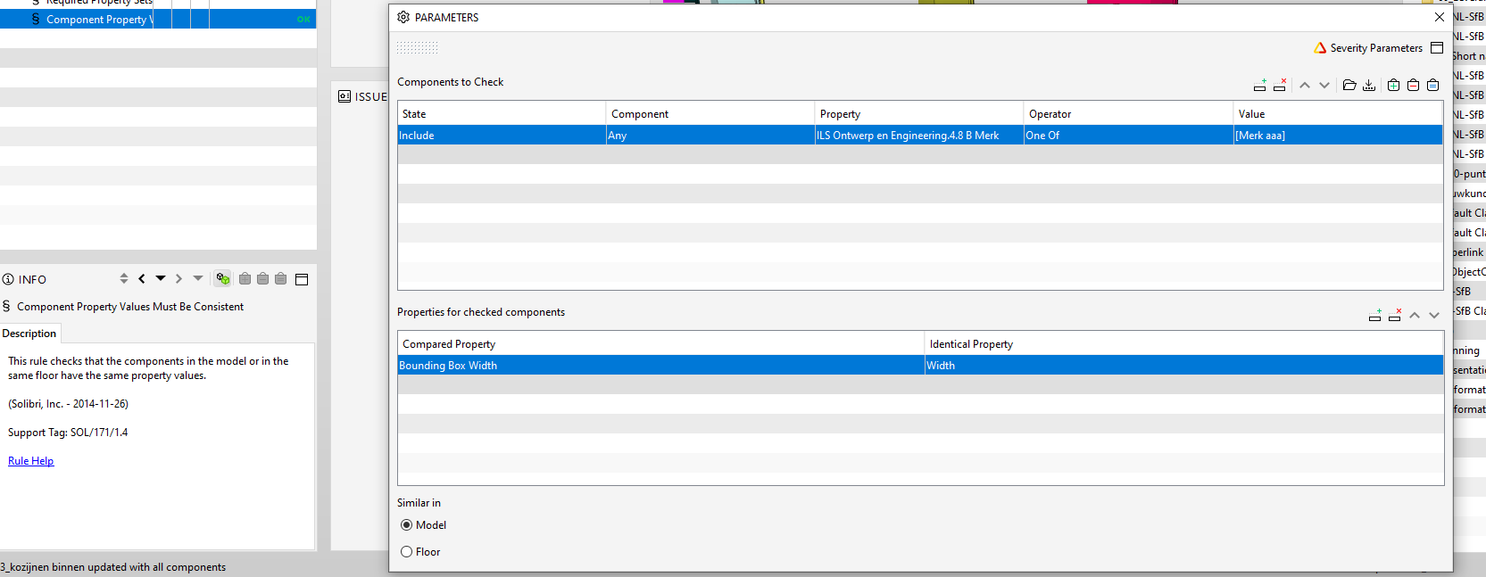

            with ruleset 171/1.4
            You can say that if 1 property is the same, a second property must also match.
            Can you do it with that?

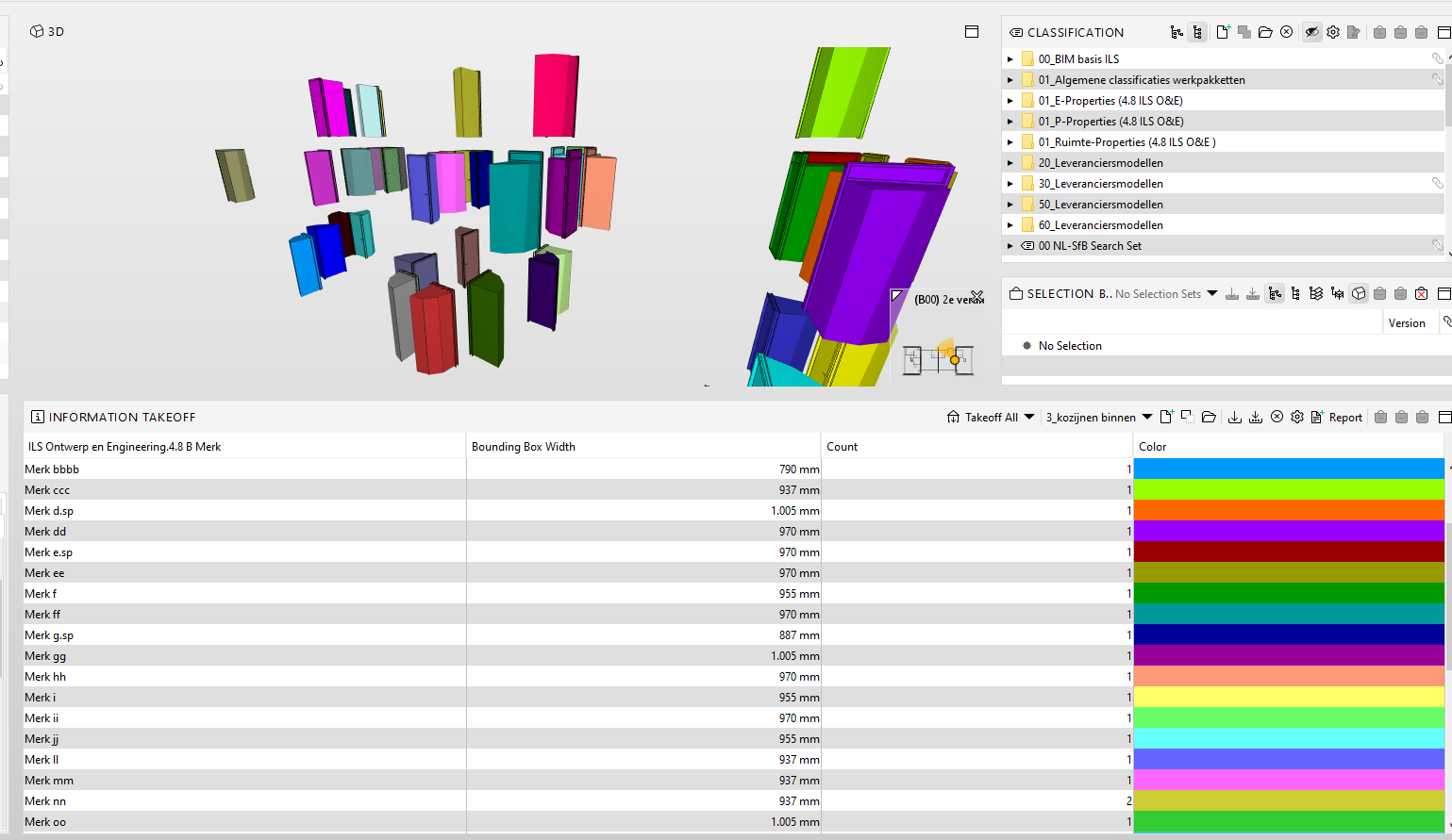

                Sometimes a ruleset is the best way to check.
                Maybe you can try to make een ITO to check quickly if the type mark are te same
                Bij grouping the mark colum there would be only 20 IDT_01A with the same bouding box. If the bouding box is different you will see two line with IDT_01a witf different bouding box with

                  Thanks, I could definitely do this, but just so I’m clear and not missing anything, this would effectively need to be a manual check on the values once the rows are grouped? If so, my concern with this is that on a large project, there could be a large number of types to be compared and it would be easy to miss one…
                  One of the things I love about Solibri both with Classifications and Ruleset is that it’s super quick to highlight and report errors without having to worry about human error on the checking side.

                    Mayb yoy can try to make a IDS for this. If the doors are good, the rule shows oke, if not you will see it?
                    But 171/1/1.4 wil do the job, as @brinkman says.
                    But you have to create 1 rule per doortype
                        @keithwilkinson
                        You can try the bounding box but I would not totally rely on those values but rather try to go with the door parameters as much as possible.
