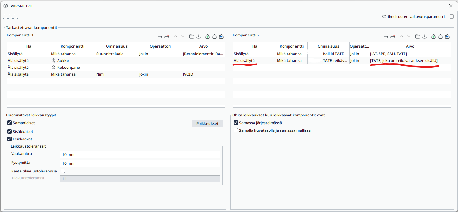

    Anyway, here is a loose guide for how I do it:
    1. I check HVAC which is inside the hole reservation objects / openings with Solibri common rule SOL/234/1.2 (in the parameter of the ruleset I use an automated classification to determine the objects for the check, but you can use certain models for example to determine the HVAC components and hole reservation components):
    The result brings me every HVAC component that is somehow inside a hole resevation / an opening. It also brings me all the hole reservations.

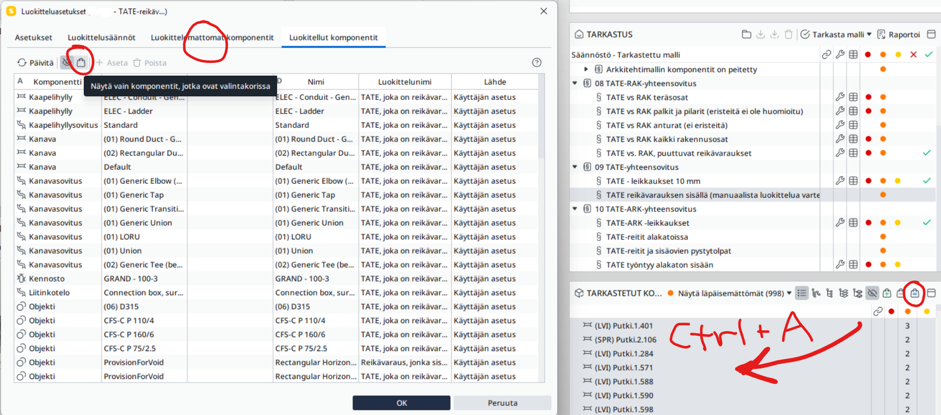

    1. I create a manual classification from the results of the former clash detection. I insert “TATE, joka on reikävarauksen sisällä” for the HVAC components (and “Reikävaraus, jonka sisällä on TATE” for the hole resevation components).
    (This is the trickiest part, I think:) To do that I manipulate the “selection basket” to include only the HVAC components by choosing all the uncleared components from the clash detection and then subtract all hole reservations with model tree. Then I manually set them the right classification. The picture here shows the results of the classified components but you should firstly use the unclassified components tab and the option to show only components that are in the selection basket:
    1. Now I should have a classification for the HVAC components that are located inside hole reservations / openings. I can then subtract them from the clash detection (SOL/1/5.1) between structural/architectural components and HVAC components:
    Hope you find some logic in this and let me know if there something missing, I try to explain better then.
    EDIT: Grammar + added some extra information to the 2nd part.

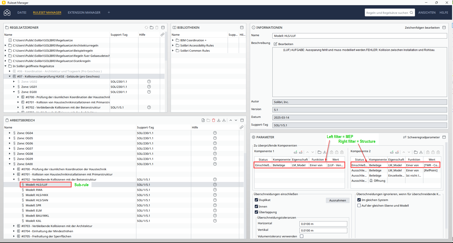

            Gatekeeper rule:
            Sub-rule:
            Note that we could have all MEP disciplines in one sub-rule, but we preferred having one sub-rule per MEP-discipline.
            RESULT:
            Step 1: all MEP components that do not clash with a Provision for Void are passed to the sub-rule
            Step 2: from those passed components, we select one specific discipline per sub-rule and check for clashes with the structure.
            Limitations: the MEP components could clash with the PFV without being centered, and without having the correct distance. This is checked in a separate rule down the road.
            Our rule #0702 (this includes Gatekeeper + subrule) merely checks if there is a PFV request for each MEP component clashing with a structural component. The other rule will check the dimensions of the PFV.

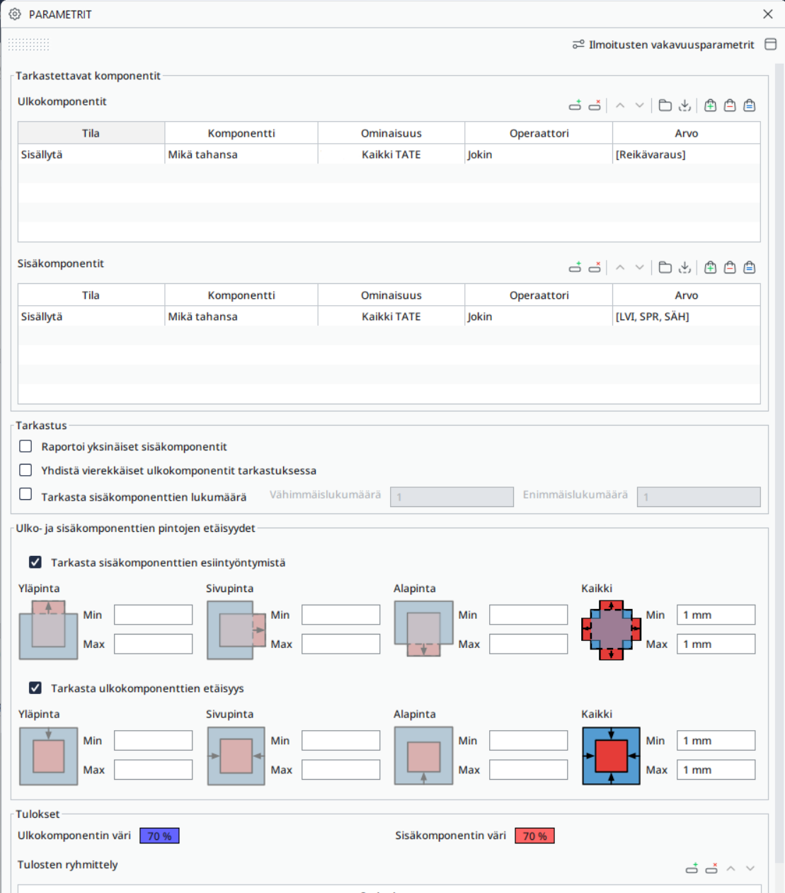

                  @Alex-J Thanks for the tips! I tried it now with simple enough setup and got it working! So, as a result, I have HVAC+E that clashes with STR where there is no ProvisionForVoid at “exact” same location.
                  I think my problem earlier was, that I had PfVs included somewhere in clash rule they were not supppose to be.
                  Also, I edited the gatekeeper rule the way that it doesn’t check for clashes but rather component inside another: HVAC+E components as inner components and PfV as outer components. I don’t know if it’s any different but maybe it’s a bit more adjustable than clash checking.
