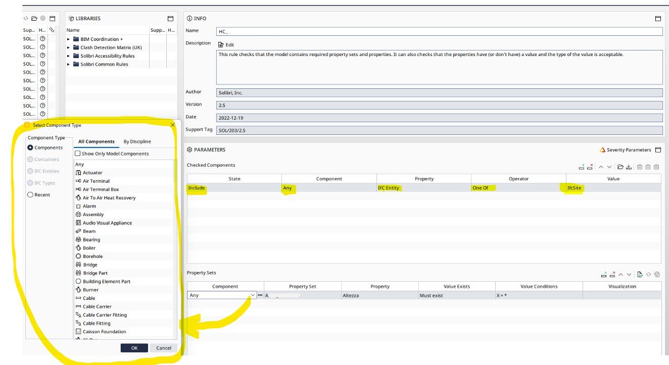

    • In the Rule “203 Required Property Sets”, in the Property Sets tab, the user can’t add manually a Cointainer:

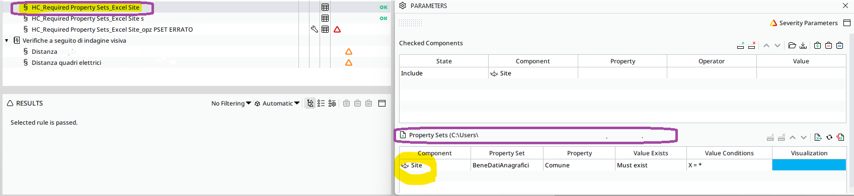

    Anyway I have notice that if a Cointainer, for example IfcSite, is added by using an excel sheet, it works (look the screenshot below):
    I ask you if it possible to add Containers in the Component Type list also for the Rule 203 Cointainers, because it is often required by project needs to check the presence of certain Property Sets in IfcProject or IfcSite, for example.

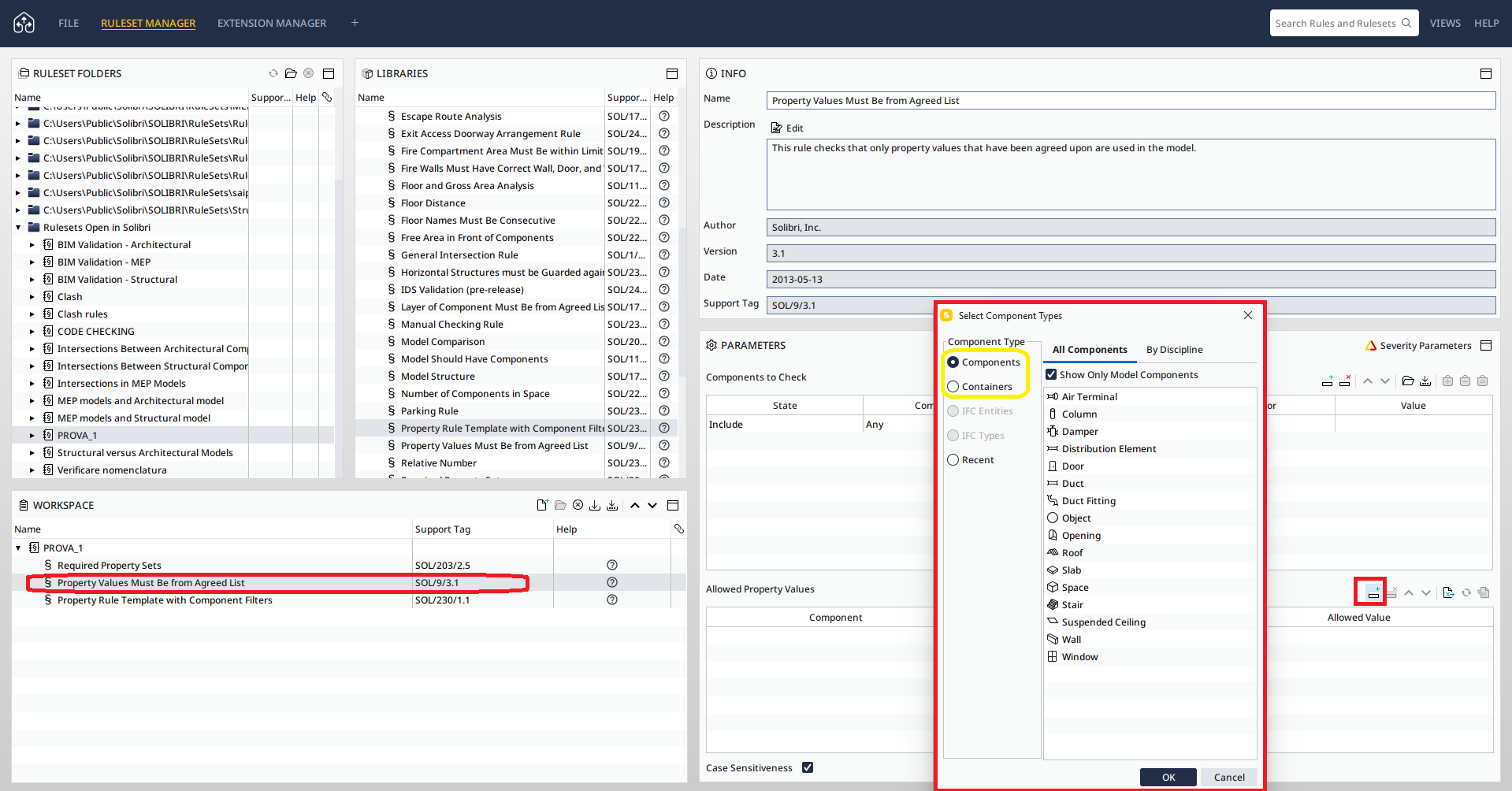

    • For the rules that allow to check properties in the models:
      The Rule “230 Property Rule Template with Component Filters” allows to add all Component Type but the user can’t import an excel sheet. While the Rule "9 Property Values Must Be from Agreed List" allows to add Cointainers and import Excel file but it hasn’t the option to filter Any Components.

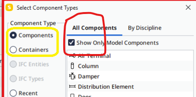

            Pasi Paasiala Solibrians
            @violarenzoni Do you have the “Show only Model Components” ticked?
            What if you untick that?

                @Pasi-Paasiala Thank you very much! I use the 24.5.0.31 Solibri Version.
                Yes I have unticked that but the condition remains the same:
