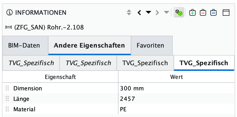

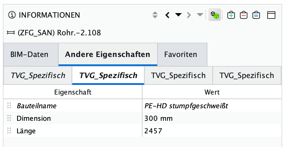

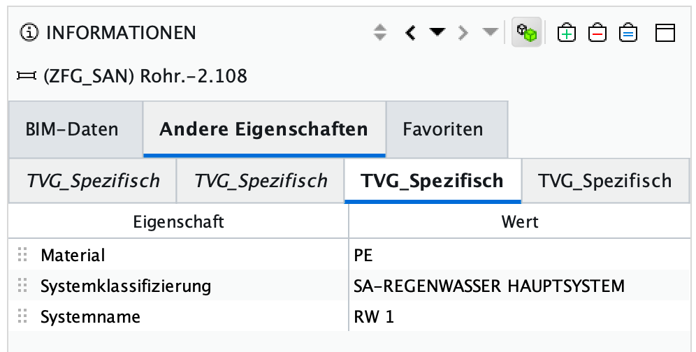

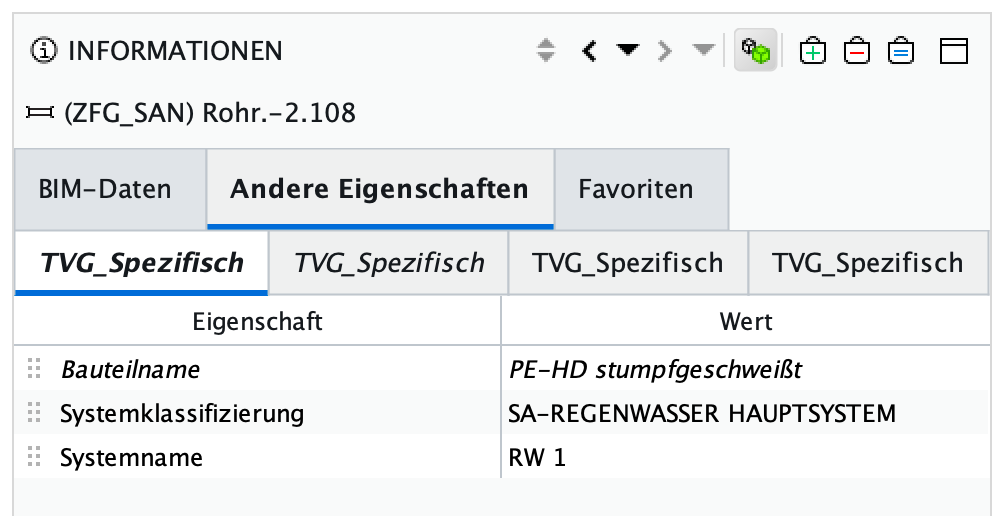

    I have just discovered that solibri is not interpreting the properties correctly as they are in the IFC model. We have a custom Pset with with 5 to 10 properties. Solibri is dividing them wildly into two or more sets with the same name.
    Here is the example:

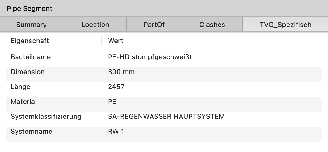

    In other BIM Viewers, the information is correctly allocated.
    The RuleSet also cannot see the PropertySets and their Properties, and it reports them as missing.
    I am currently using Solibri 24.5.0.31 on Mac OS X 14.5 x86_64
    Can someone help me with this case before I produce thousands of not valid issues?!?!?

        Another thing that I don’t understand is, why BIMcollab Zoom defines it correctly, but Solibri not!
