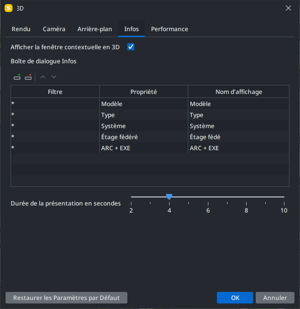

        Yes, the picture was taken from Solibri help page but here is a brand new capture with the dark mode.

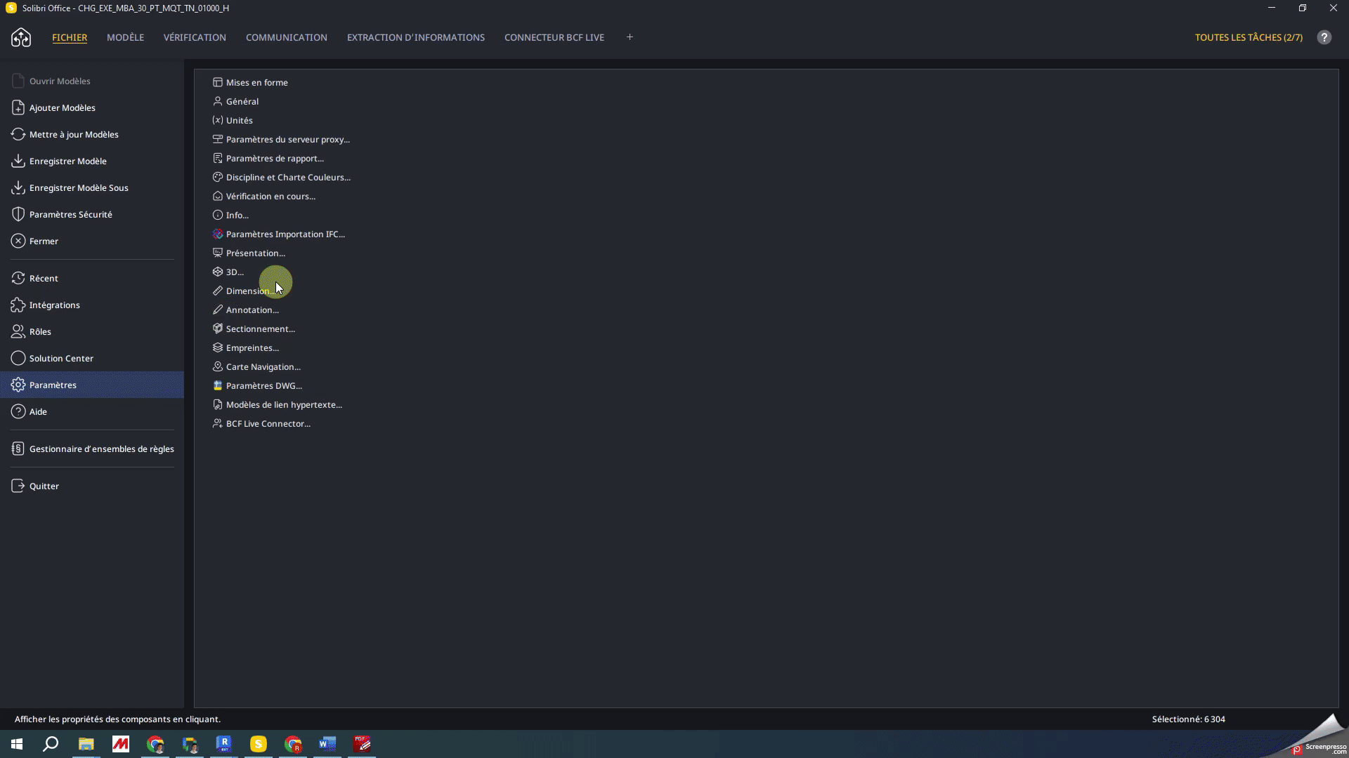

            Yes it’s this pop-up. It is really weird. Here is a video of the problem :
            • jakub.rusinJ Offline
              jakub.rusin Solibrians
              Alright! Thanks for the report and video. Weird indeed. All I can suggest for now is reinstalling Solibri if possible. And I will try to gather more information on this.

                Could you try changing the settings of the pop-up? Use only one simple row, like:
                See if that allows the pop up to be shown.
                Please also contact our support: [email protected] and provide the logs.
                • rageR Offline
                  rageR Offline
                  rage
                  Unfortunately, even with just one line, the song remains the same. I sent the logs, thanks.
