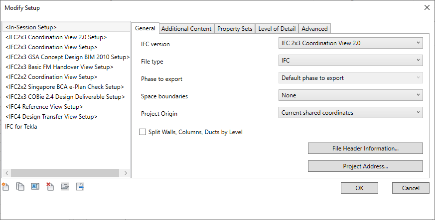

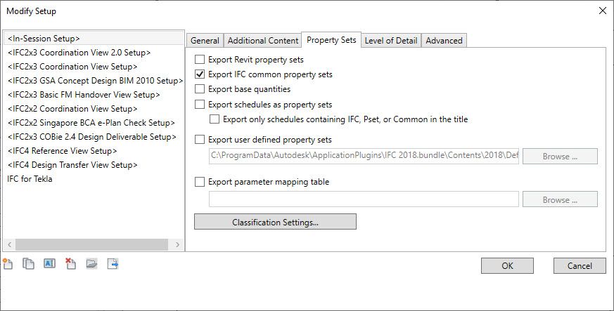

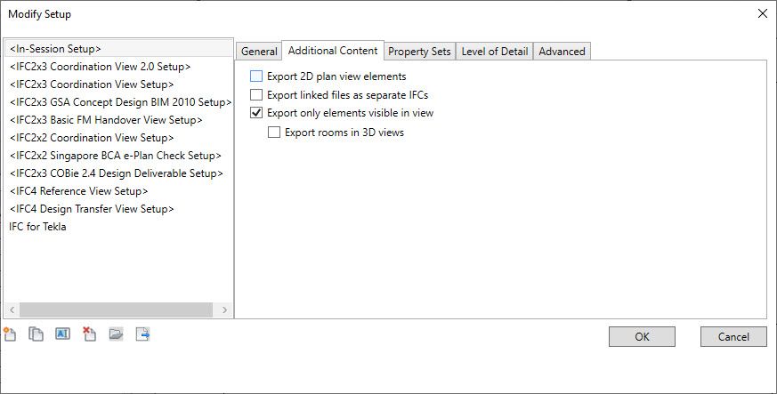

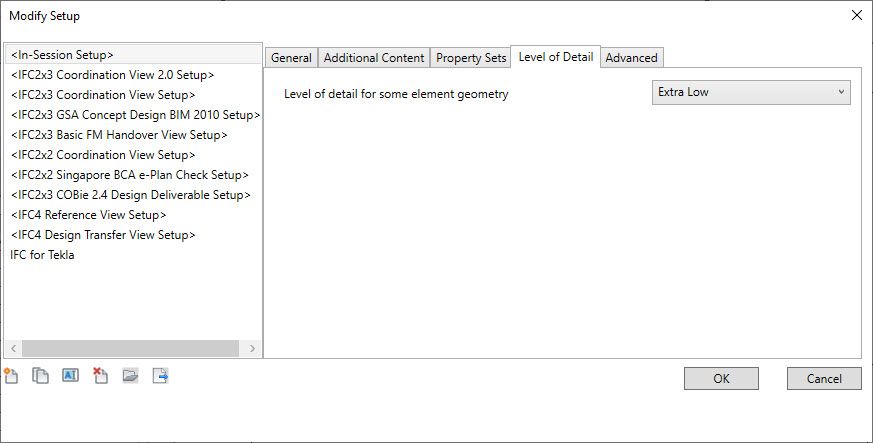

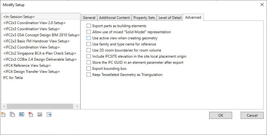

        What exactly do you want to know? We tried to use a low detalization and tried an export without Revit Properties. Below you can see a screenshots with a parameters:

          Because you use “Export only elements visible in View”:
          1. Am I exporting from a 3D View, without elements hidden in view / filers / hidden elements from Worksets?
          2. Are elements in the right phasing before I export them? Phasing in View is what you export.
          3. Is the detail level in the 3D View set to Fine / Medium? (Course is generally not good for export)
          Extra:
          1. I don’t advice using Extra Low for your exports. Lower detail typically means lesser accuracy (both in geometry visibility and quantities).
