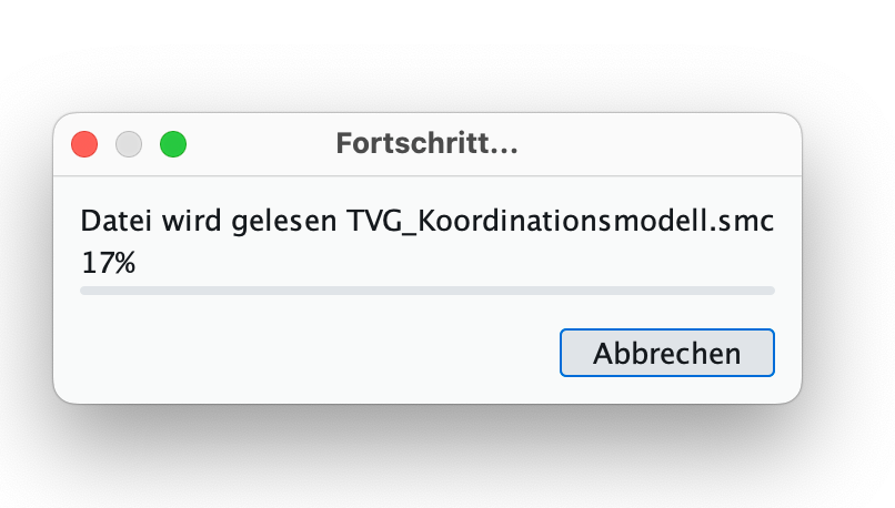

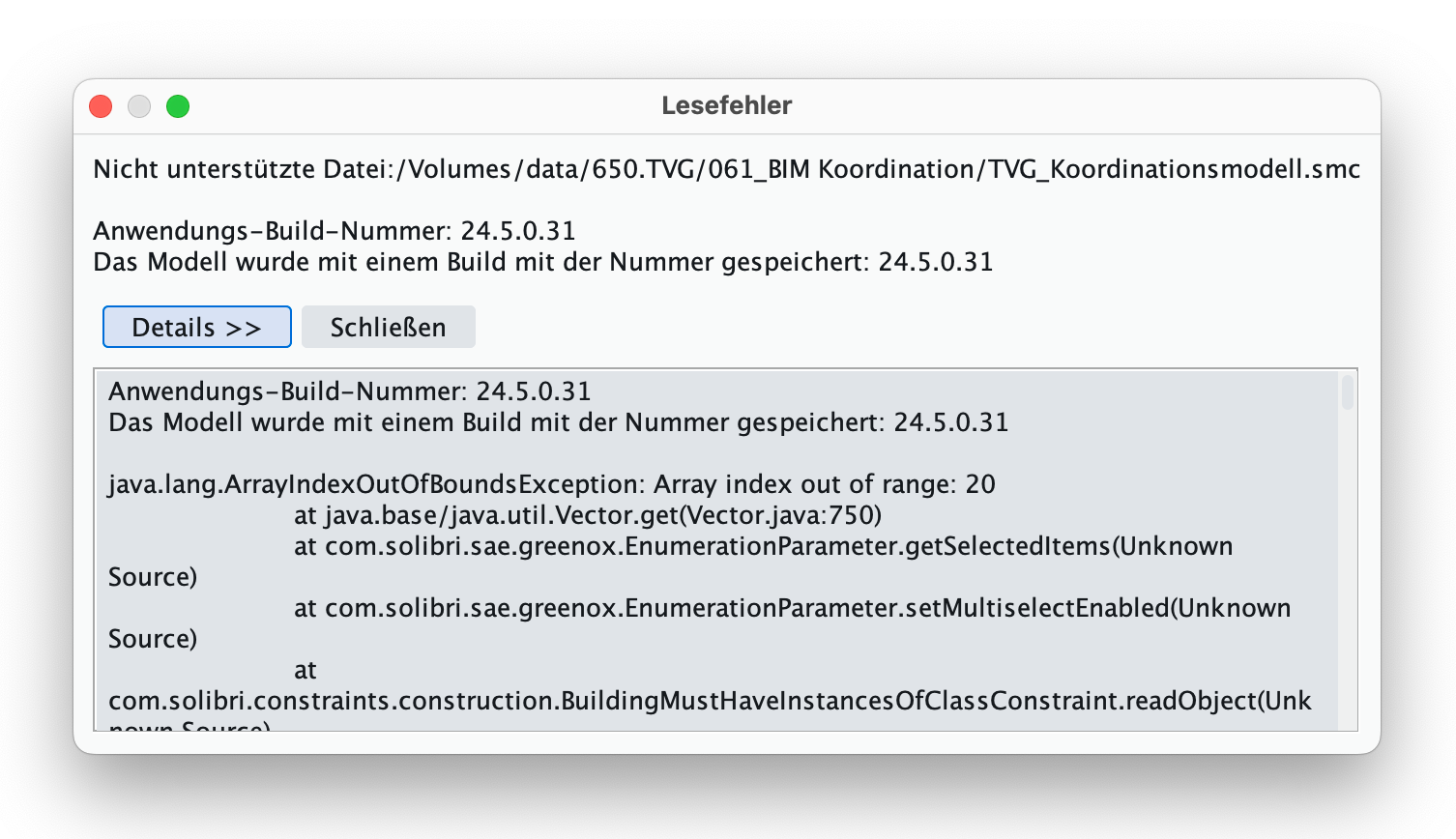

    I am experiencing a problem with my smc file, which since today, I cannot open. Yesterday I saved the file on our server and today I cannot open it anymore. This is the message that I receive:

    What is also strange, is the loading bar. It shows the percentage, but the blue bar is not visible.

          The backup is created every time you save a model. In the settings you can control how many backups are stored. The .bak file is always the latest backup. The other ones are earlier.
            The next version is fixing this ā€œEnumerationParameterā€ problem. In case you don’t have a backup Solibri support can help you recover the file.

                      one tip that I can give to all experiencing this problem.
                      If solibri crashes during opening of a file with the error message above, what helped (in my case) is to fully close solibri and open it again. Was not expecting this and I found out by accident šŸ™‚

                          A hint for anyone struggling with this problem.
                          I might have found a way to open these ā€œcorruptā€ files. I just close and open solibri. After this, solibri is able to open the file. I don’t know how this could impact the file but, this is the only way that I am working currently.

                              #14
                              so far as I have tested, it seems to me that both are the case.
                              I tested this method also with a file that was clearly missing some Mb. Solibri (after closing/opening) could not open this file. For another file, that seemed plausible in size, this method worked.
