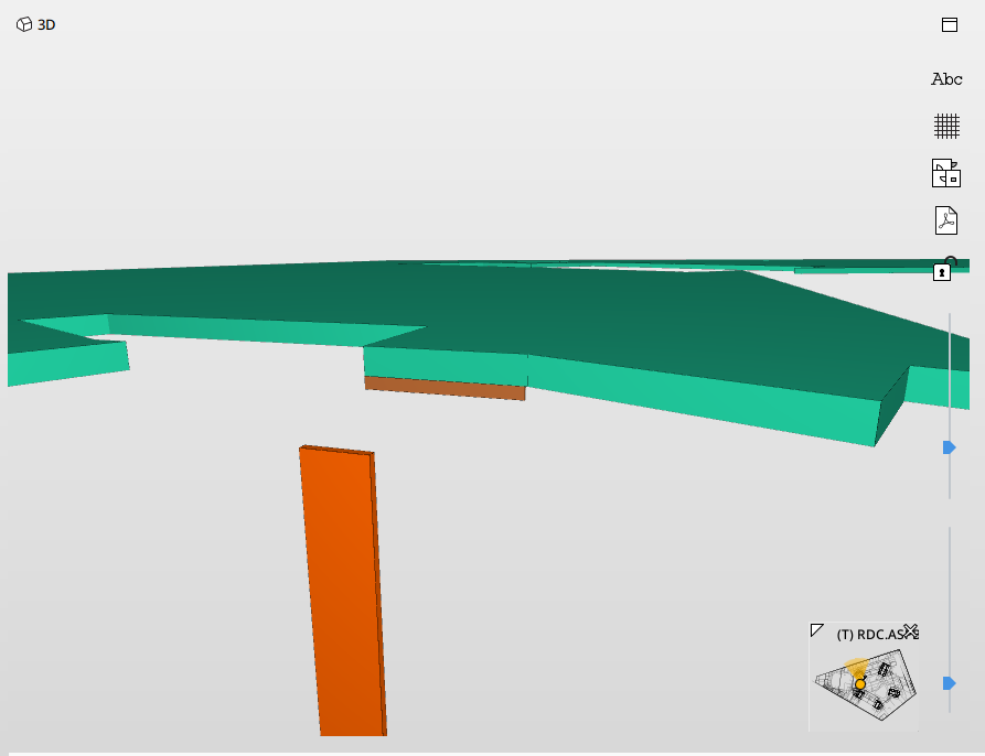

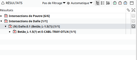

        However, that’s not the solution I am looking for. When performing a recheck with updated models, the rulesets do not perform as they should. As shown in the picture I provided:
        Before updating the models: The cable carrier clashes with the slab.
        After updating the models and the presentation with the BCF file from the MEP team: The issue is resolved in the 3D view. However, when performing another check to identify any new clashes in the updated models, Solibri still detects a collision with this cable carrier and the slab, even though it no longer exists.

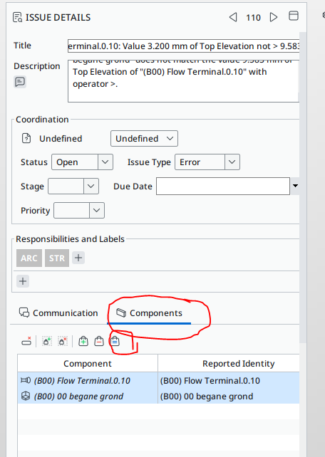

          In the issue, click on the tbbbald components and select the components there and press =.

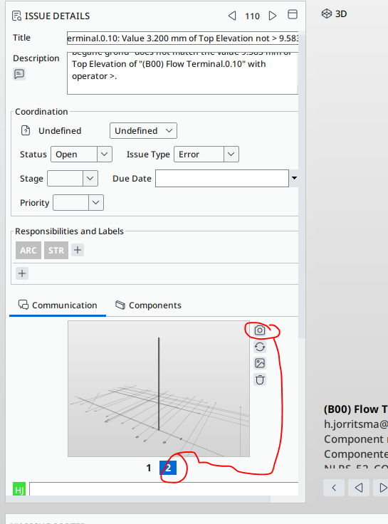

          Then the components that remain in the clash will become visible. If you then press the communication tab and add a new image, you can send it again.
