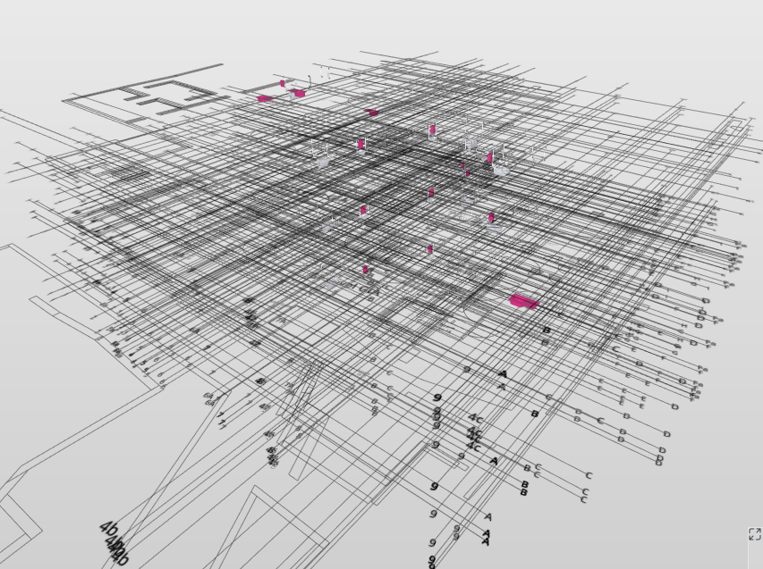

    I can’t figure out why every time I do a clash detection and load my models in, the grids and plans are a total mess (see image below). When this happens I tend to switch them off from all views and from the clash result slides, and I ideally would like to have them in as they can be very useful.
    How do you make sure those are tidy and you don’t end up with duplicates for each one?

      If one IFC has a grid… Solibri will project this grid on every level that is in your smc.
      So if you have a lot of models… with different levels with different heights… and only one has an IFC grid… then you get somelthing like your picture.
      You can make an ITO of the levels to check different levels and heights…
