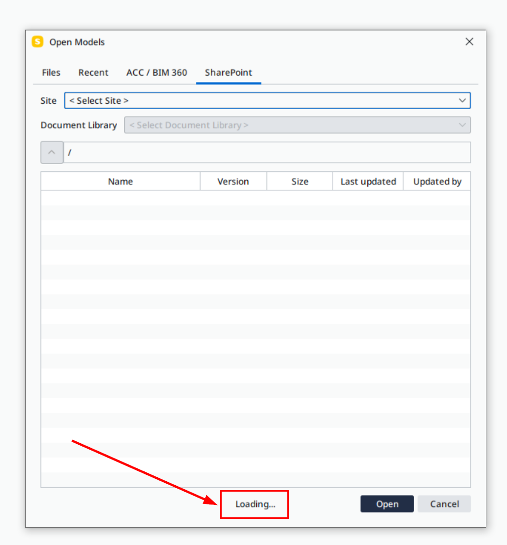

    I try to use the Sharepoint integration but I can not choose any Sites and it says “Loading” for a long time.
    Anyone else who has this problem?
    Is it possible that this is because there are a lot of Public Sites within my company and he is indexing all thes sites?
    Any feedback would be appreciated.
    Jeroen

                          The Solibri SharePoint feature is using following query for listing the Sites:
                          GET https://graph.microsoft.com/v1.0/sites?search=*
                          The resulting error is 403 : Error code: accessDenied
                          So this must related the rights given for Solibri by admin.
