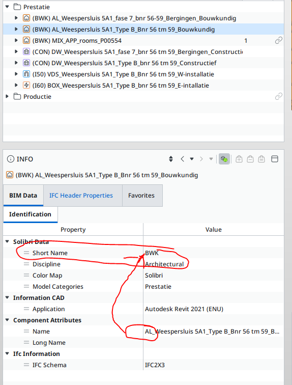

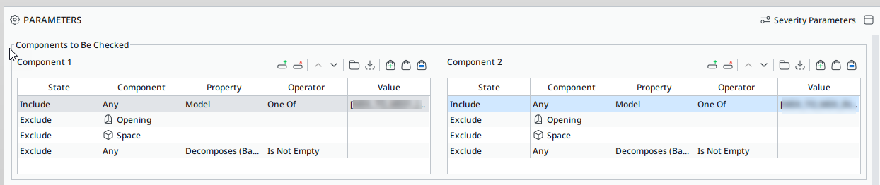

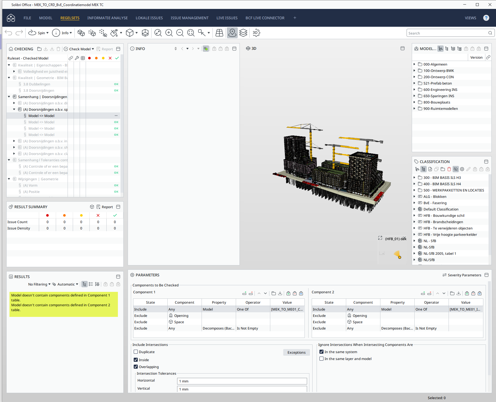

    When you want to clash 2 models and use the filter “Model” <> “One of”, it doesn’t give any result.
    When you use “Short Name” <> “One of”, it will give the right result.
    (or any other filter)

          From version 2024.9 to 2024.12 there is a change in the way Solibri use model/shortname.
          Before u can use teh shortname using (model)name.
          This is now not possible, you have to change this to the shortname.

            @Solibrians As far as I can tell, this Filter Model > One Of still doesn’t work in the latest release 25.3.2.65
            Will this be fixed in an upcoming release?
