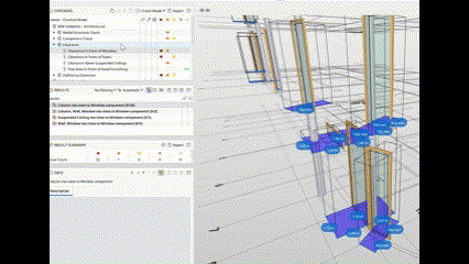

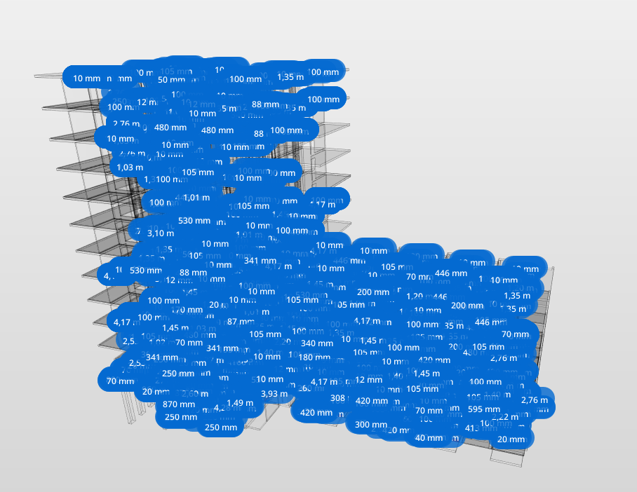

    In the clash matrix, the clash dimensions are shown with large blue labels. This makes the view very cluttered, especially when there are many clashes. It would be helpful to have an option to make these labels smaller, more transparant, or to temporarily hide them to improve visibilty and usabilty.

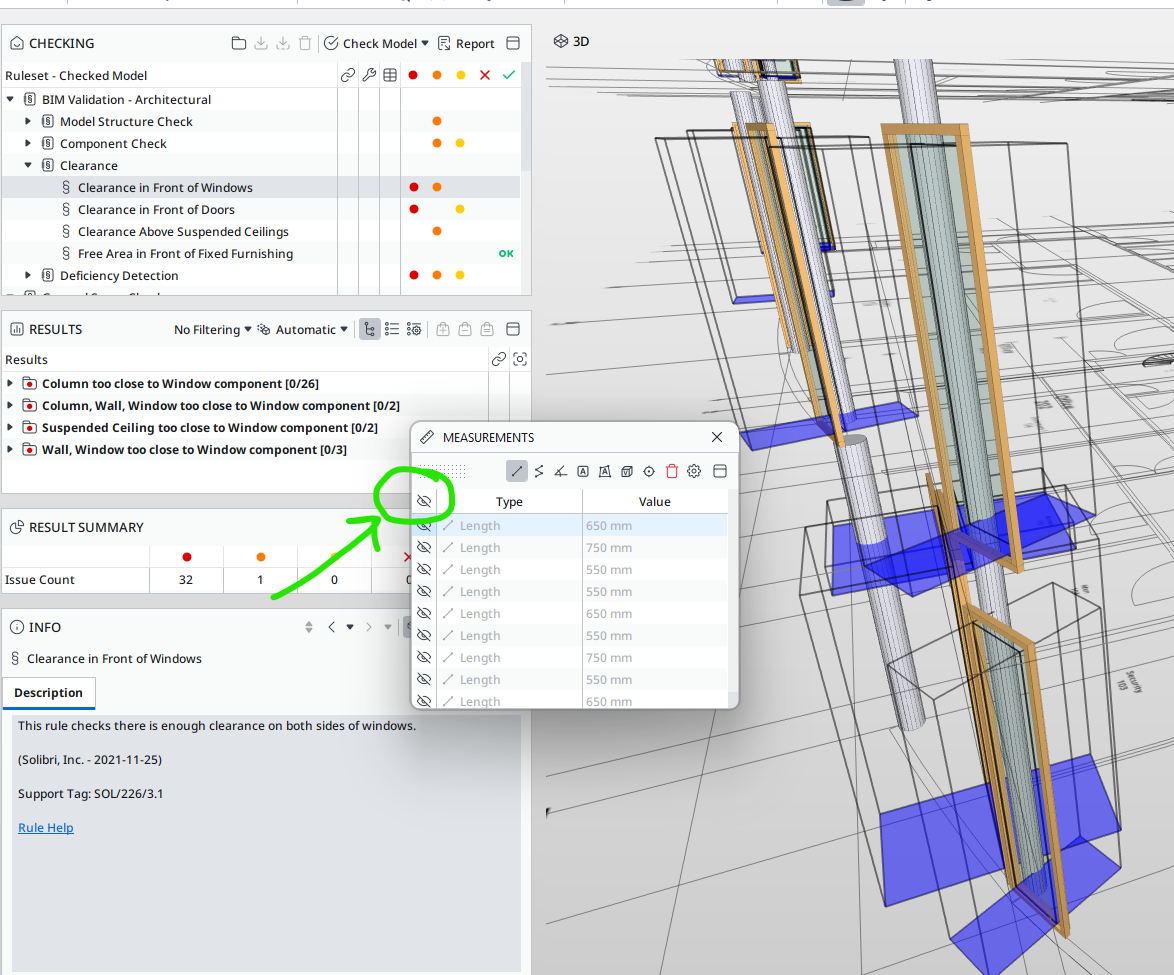

          @yb_ Not sure if this helps in all cases, but it is possible to open up the measurements dialogue and temporarily hide measurements in any view which has measurements. Simply select the measurements (or select one and ctrl + A), and use the hide functionality:

            Just wanted to mention that when there are too many clashes, it can take 3 minutes or even longer for the measurements to load or respond. That makes it quite difficult to work efficiently, especially when trying to toggle the visibility of the labels.
