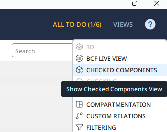

      Hi Ville, you can use the ‘Checked Components’ View for this. It’s available from the ‘Views’ pulldown menu in the Layout bar.
      You use the ‘Checked Components’ View in combination with the ‘Checking’ View:
      • Perform a Model Check

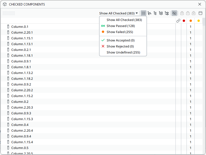

      • Select a Rule in the ‘Checking View’
      • The ‘Checked Components’ View will list the components that were handled by the Rule.
      • The components can by organised in various categories: ‘Checked Components’, ‘Passed Components’ & ‘Failed Components’
      • But also: ‘Accepted’ , ‘Rejected’ & ‘Undefined’
      • You can visualize the components in the list in the 3D View by selecting one, or multiple rows
      This View is indeed especially helpful for ‘debugging’ Gatekeeper Rules. It gives you insight into which components have been checked and which components are passed on from the Parent Rule to the Sub Rule.
