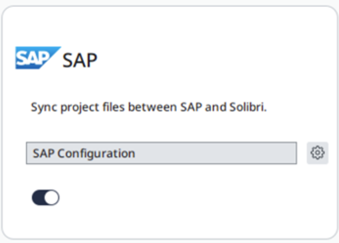

    The configuration file is selected in the Solibri UI:
    Once the configuration file is loaded, authentication will commence in the same fashion as any other integration within Solibri by turning the integration on. As an important note, the Solibri SAP client uses OAuth Authorization Code Grant to obtain access token. The redirect URL needs to be setup when configuring access for Solibri. The default redirect URL is: http://localhost:10556
