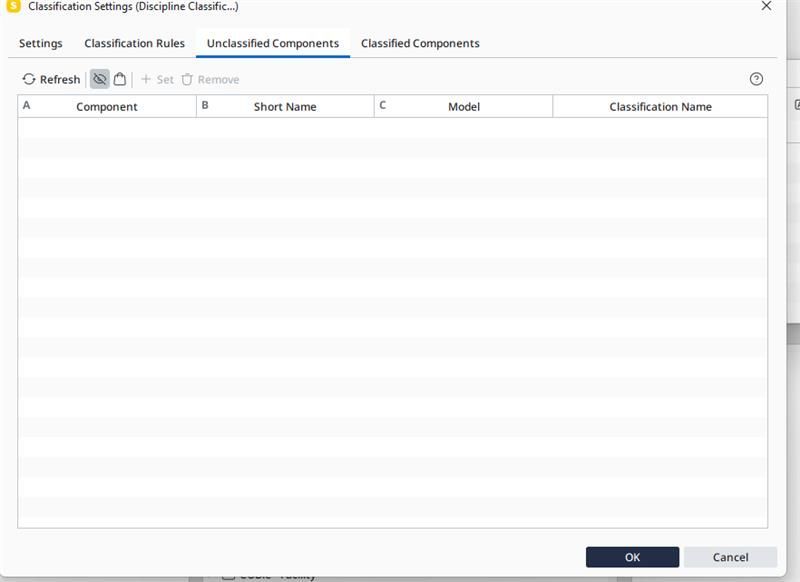

    Having an issue where the classification codes arent classifying unless i go into the classification and click on classified components

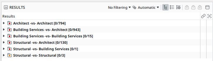

    This image is a clash result first run with Arch/Structures/MEP
    this image shows that the MEP is marked as unclassified
    Check unclassified and nothing is there

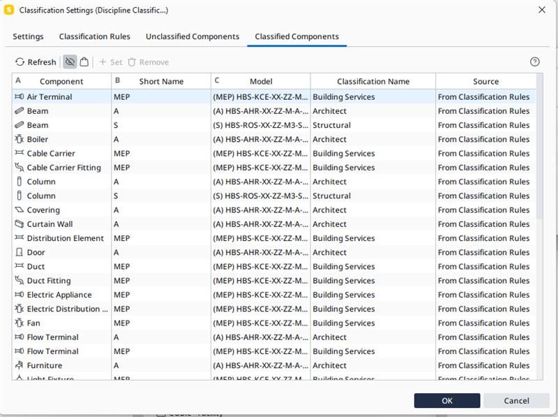

    Go to classified and i can see the MEP components and these are marked as MEP discipline classification
    It is now recognised
    And the Clash detection now works as expected again
