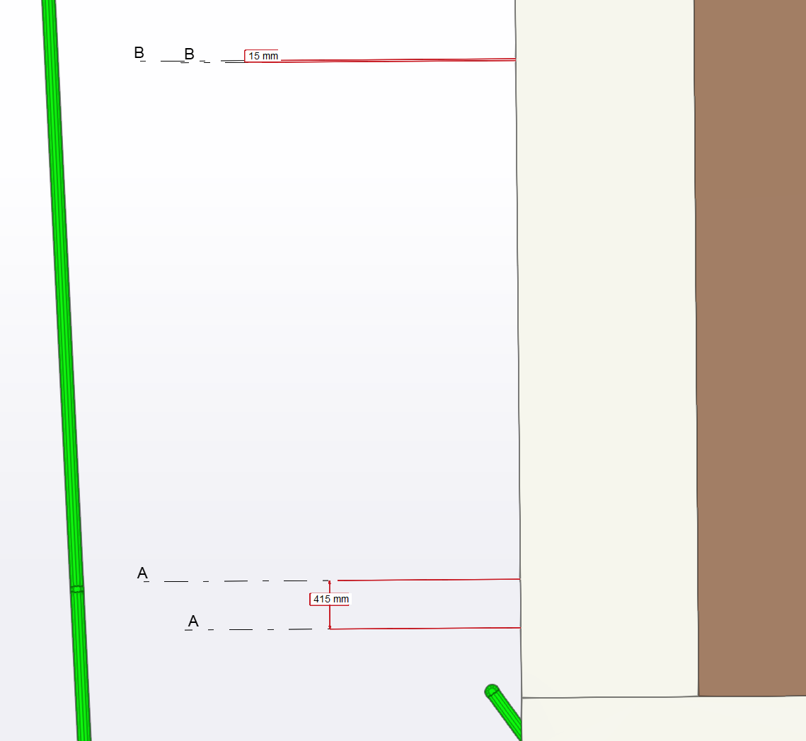

    Hello,
    is there an elegant way to compare/check grid for inconsistencies? I have grid in architectural and structural models.
    Perhaps there is a way to display grid lines in different color based on their model?

      If you want to checkt height (Z-value) of building storeys, it is best to check with an ITO the levels of all models.
      Solibri is projecting grids on every building storey (with some exceptions i do not really understand).
      So if you have a model without grids with wrong levels, it will project the grid of another model on that wrong levels.
      It is also possible that you have grids in more models, and that the grids differ from eachother. Solibri will display all grids from all models.
      Best practise is to use a levels and grids model and ask all other parties not to export grids in other IFC’s.

          @JeroenKoomen Thank you for your reply.
          I do check levels based on rules.
          My idea is that if architectural and structural models levels are not in the same place, there is no point in checking if architectural and structural elements match.
          I was hoping to stage model checking - first check grid, floors, Site X Y Z and only then - elements.
          • JeroenKoomenJ Offline
            JeroenKoomen
            OK. Do not think there is a possibility to check if grids are the same in models…
            Would not recommend it either to have a solibri model where all models have grids because of the limitations Solibri has in how grids are projected…
