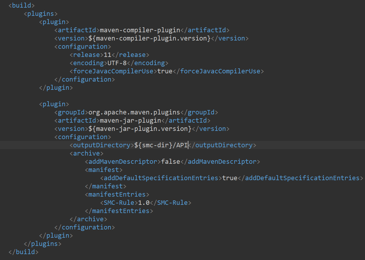

    Reading around the forums it seems to be possible change the build path by modifying one line of the pom.xml file, namely the <outputDirectory> tag, so that it would look like so <outputDirectory>${smc-dir}/API</outputDirectory>.
    Trying to build the rule with this parameter, however, results in an Error.

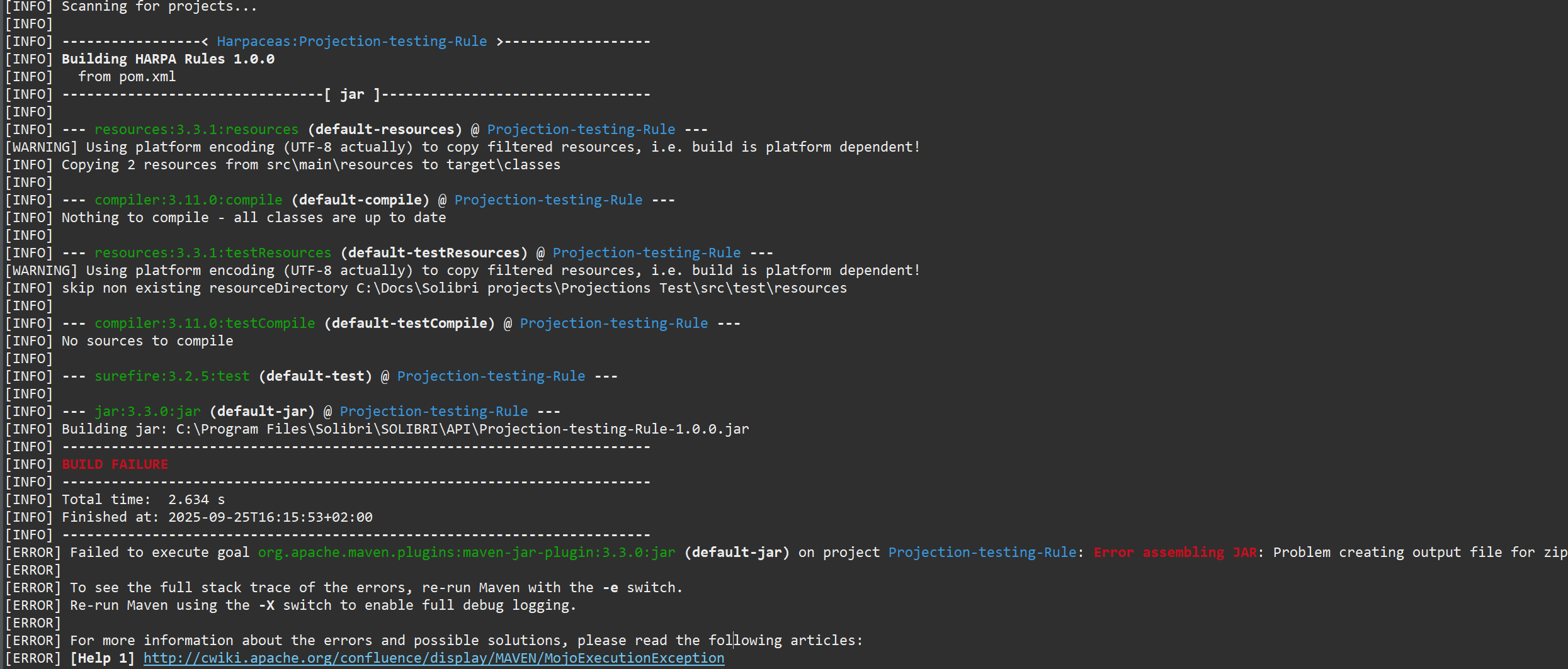

    °[INFO] ------------------------------------------------------------------------
    [ERROR] Failed to execute goal org.apache.maven.plugins:maven-jar-plugin:3.3.0:jar (default-jar) on project Projection-testing-Rule: Error assembling JAR: Problem creating output file for zip C:\Program Files\Solibri\SOLIBRI\API, C:\Program Files\Solibri\SOLIBRI\API\Projection-testing-Rule-1.0.0.jar -> [Help 1]
    [ERROR]
    [ERROR] To see the full stack trace of the errors, re-run Maven with the -e switch.
    [ERROR] Re-run Maven using the -X switch to enable full debug logging.
    [ERROR]
    [ERROR] For more information about the errors and possible solutions, please read the following articles:
    [ERROR] [Help 1] http://cwiki.apache.org/confluence/display/MAVEN/MojoExecutionException

    Defining other folders doesn’t work either, the build wants the lib folder as the output directory.
    The linked page just says it’s a configuration problem, which isn’t particularly helpful.

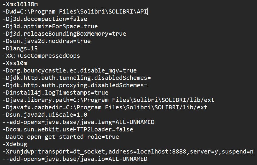

    Changing the vmoptions path yields no results either

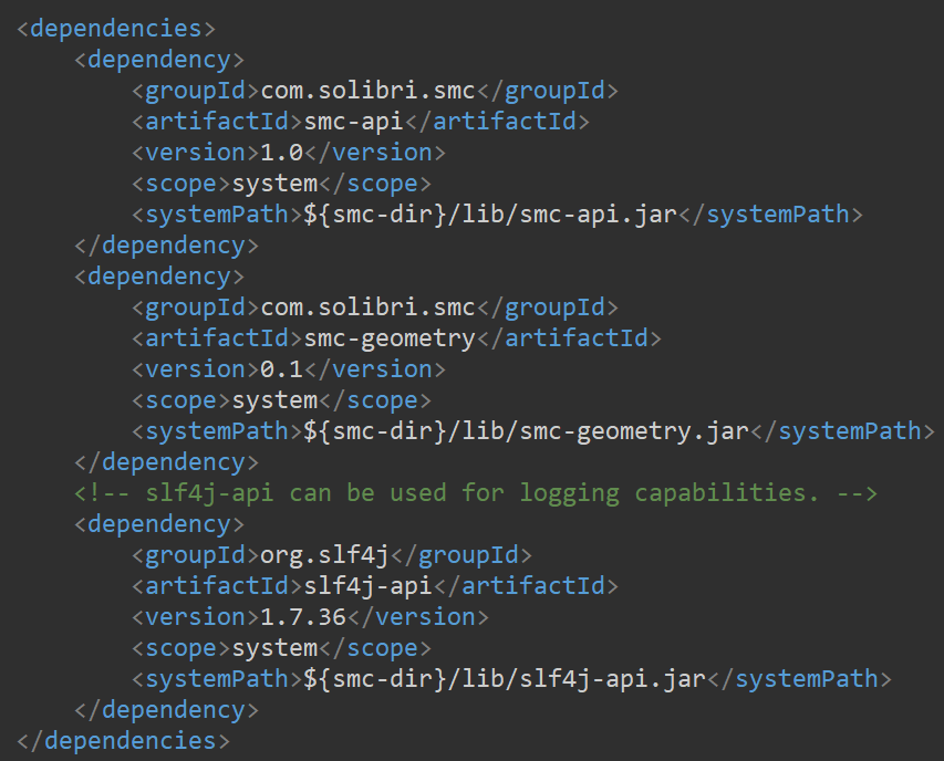

    The pom file has been taken from the “Getting Started” example file and has been changed only to specify the rule details. I’ve noticed that the dependencies path can be changed as long as the new path contains the jar files it references.

      Not sure what you changed but would not alter anything in the vmoptions but solely change the pom.xml
      Add a new parameter
      <api-dir>C:/Users/Public/Solibri/SOLIBRI/API</api-dir>
      and use it only for the output but keep the smc-dir as it is to be able to use it for all the dependencies.
      <outputDirectory>${api-dir}</outputDirectory>archive>

        To give a little more context to what I was doing before, I’ve seen people change the Dwd line (second one) on the vmoption to point directly to the API folder, so that was an attempt I made. I’ve also enabled debugging there but I hope that it’s unrelated to this matter.
        Regarding the new parameter, I see you point it to a different folder than I do. Solibri only sees custom rules in the C:\Program Files\Solibri\SOLIBRI\API folder, which means it won’t see them unless they are manually moved to the right path. Coincidentally, trying to build into the right path fails.
        By running Eclipse as an administrator I was able to build directly into the API folder. That is the only way I found.
          Might work as well, if you change the Dwd value but then it is not global anymore (e.g. if you have multiple Solibri Versions installed).
