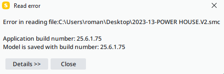

Error in reading file with the same version of solibri
Hello, is there anything I can do about it?
File size is 866MB
File is on the local desktop, so no strange paths.
I have tried opening it with original and newer solibri version - the message stays the same.
Some how all backups and cloud versions are one day older
Hello,
What does it say when you open de Details button?
I have had the same problem with a big model where it said i was out of memory
there is al solution described in the following topic: https://society.solibri.com/topic/1200/opening-a-big-smc-file-failure-of-memory?_=1756966382064You have to increase the usable memory in the vmoptions
